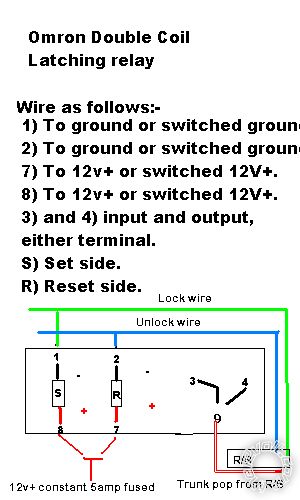

Absolutely not use this:-
Manufacturer: OMRON ELECTRONIC COMPONENTS
Newark Part No.: 82X7238
Manufacturer Part No G5RLK1AEDC12
About $5
That's the Farnell number, I used these over 20 years ago on a Clifford Solaris with only one aux, used it as a trunk release with alarm on, headlights with alarm off.
Posted: September 13, 2015 at 11:19 AM / IP Logged Link to Post Post Reply Quote howie ll
The relay grabs the 0.8 second POS on lock to LATCH it so you've a constant ground, then when you unlock it grabs the unlock 0.8 second POS pulse to open the circuit. How do you think an alar's ground when armed works?
This is an earlier Omron showing typical circuits:-
