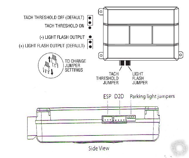

I am installing the AVITAL 4105 remote starter to my 2003 Toyota Camry. I got lots of information from this 12 volt site. I download the installing guide. I had installed the 4 relays. One for second starting wire, one for trunk and two for disarm/rearm. They all seem to be working fine. I can do lock/unlock and open the trunk with new remote. But I cannot start the engine yet. I can start the engine if I put my key near the ignition barrel. This mean my bypass module is not working properly. I have connected the PKALL 6pin connector only not 4pin connector yet. Here are my connections:
RX=pin4 GREEN / WHITE
TX=pin5 blue / YELLOW
Key Sense=Blue
While running (status) =Status output
In few days I will try to connect the other 4pin connector according to the diagrams then I will let you know if it is working or not? If not then I will ask you to help me. Today I need only one information. That information is about parking light jumpers. Please look at the photo. The top one is taken from the installing guide and bottom one is taken from my remote starter sheet, which came with the remote starter. Both are not matching. Could you tell me which side is (+) side? D2D side or other side? Sorry for poor English. It is my second language.
