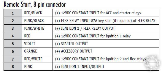

On both of these units, there is no Green wire like the other units for starter kill. Can someone help or show how to wire a starter kill with the available heavy gauge wires in the picture below? Are Viper units normally open or close starter interrupt wiring? If a vehicle has 2 starter wires how would it be wired differently for starter kill?Viper 4706V & 4806V Starter Kill wiring? -- posted image.

These models wont have the green wire for starter kill because they don't have the alarm feature, only remote start and keyless entry. But you can make your own with a relay and using the orange Ground When Armed wire which is on the 6 pin main harness.
86- ignition
85- GWA(orange wire of viper)
87- Not used
87a- Key side of starter wire
30- starter side of starter wire.
If there are 2 starter wires, which is common in Toyotas, you can do this for both, but its on really needed for one since you would need both starters wires to start the car.
