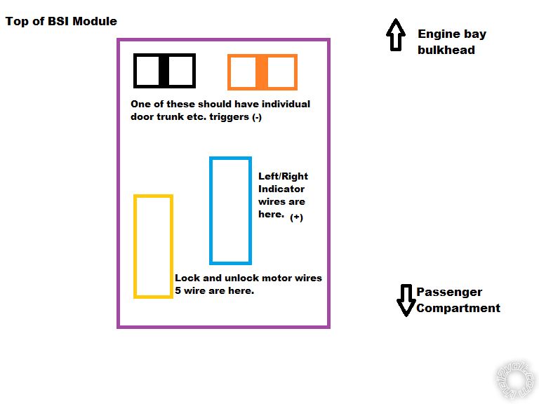

Find the BSI module, one plug, this has the motor wires when you lock and unlock.
In fact standby I'll do a diagram!
Most auto electricians in the UK won't touch French or Italian cars especially Peugeot/Citroen.
Posted: October 21, 2015 at 8:48 AM / IP Logged Link to Post Post Reply Quote howie ll

Thank you so much!
So you suggest to go directly to BSI connectors? I thought I can took signal somewhere from wiring loom coming from drivers door, to avoid messing with BSI.
I will check this as soon it stops raining here :)
I still don't understand that car... What is the reason I can unlock but can't lock? DOes it has some pulse signal or what?

One question: I found lick unlock wires in door. Aren't they the very same wires on BSI connector? Or there is something "between" I am missing?
I googled for last 10 days, found many different schematics for fitting alarms into Pug 406, but I couldn't find a clue why is it that way...
Once again, I took 6-pin connector off from door actuator. I simulated lock and unlock with key in door barrel. Found which contacts are for unlock and lock. When I test them in live (by connecting wires), only one way is working. If I try with key in barrel, it works both way! It look like some french engineer made it deliberately to make life harder :)

Yes, I understood. I have to check directly at BSI, not to trust what is in door. I will try to rely on Autodata wiring codes first, hope they are enough correct.
