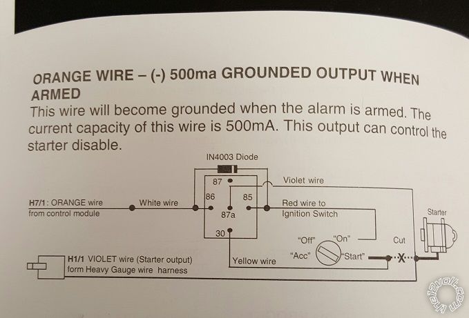

2011 honda pilot autopage rs-665-2w -- posted image.
3.     Can I hook up the (2) 12 volt inputs from the H1 6pin, and the System power 12 volt from the H2 5 pin all to my white (50a) 12 volt at the ignition?

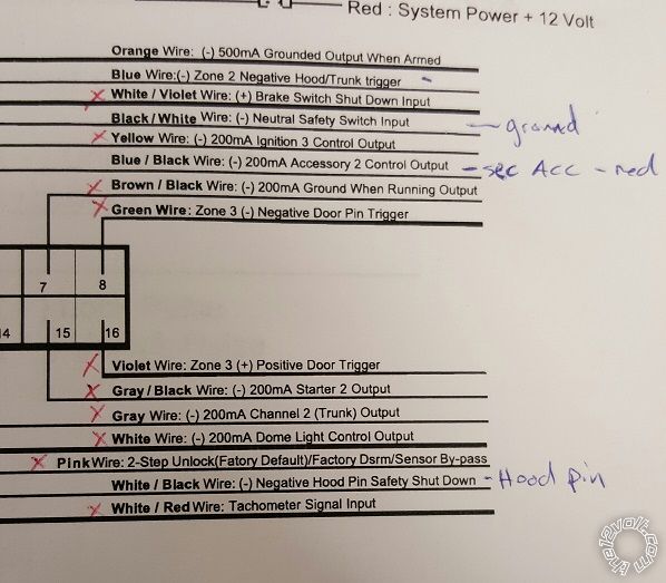

4.     Can you tell me if this looks correct the ADS should take care of most of the red x’s and some aren’t necessary.

Now the orange - i have come to the conclusion that is only used when connecting a starter kill relay. Which i am not. So not connecting that wire.
I think i will be okay if i go ahead and hook up all three 12 volt wire from the alarm to the 12volt white(50a) from the car.
I sure i am good from there that the ADS will handle the rest.
