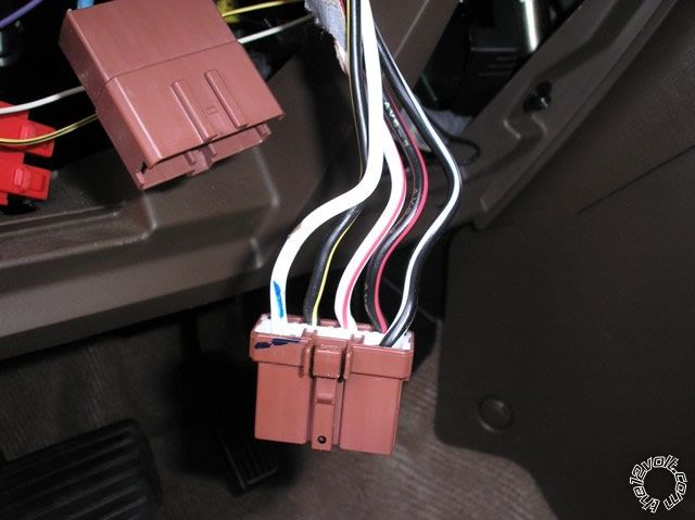

Check the heavy gauge black/red and white/red wires in the ignition harness.
Remote Starter, 2003 Honda CR-V - Page 2 -- posted image.

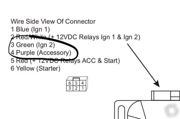

They should be connected to the green and purple wires from the heavier gauge 6 pin harness of the remote starter.
