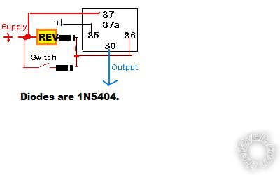

Meanwhile here's an even simpler way of doing it:-

Posted: November 15, 2015 at 10:43 AM / IP Logged Link to Post Post Reply Quote howie ll
Oh very funny! On a serious note, FUSE the common wire to 87 and 86 BEFORE the switch. This wire is a 12V+ constant.
