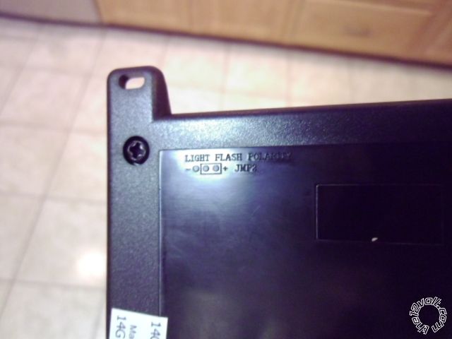

Are you looking at the jumper from the top or bottom?  On the 4103 I have in my hands, the jumper is on the inner side next to the red 4 pin D2D port for (+) Parking Light output.  There should be polarity symbols molded into the black plastic body on the bottom of the module.  Might need a flashlight and magnifying glass to see it...

here is a photo :
1995 Chevy P/U Parking Lights, Avital 4103 -- posted image.

I have the jumpers like the photo. Still nothing. I hear a relay but isn't there more than one relay? Everything else works great.
