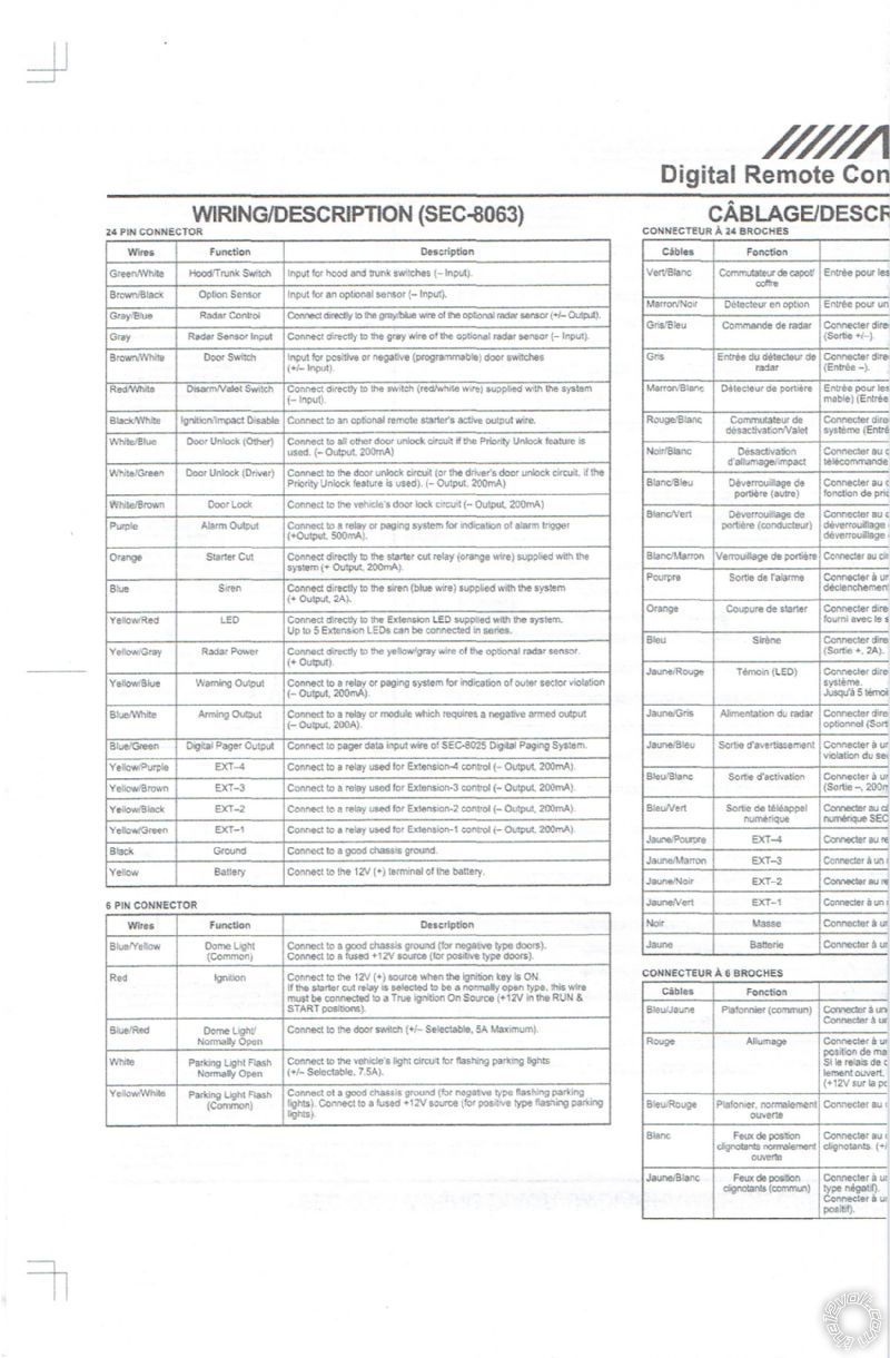

OK,First post..
Been signed up for a long time..Now I need a lil help..
Ive got a 99 Chevy Tahoe,4Door.
Im installing an Alpine/8063 Security system.
Heres the wiring for the alarm,
1999 Tahoe, Alpine SEC8063 door lock connects? -- posted image.

Any advisement?
dingo1
Joined: November 22, 2015
Location: Alabama, United States
Posted: December 02, 2015 at 9:21 AM / IP Logged Link to Post Post Reply Quote dingo1
No luck..
I was hoping to determine weather I can connect directly,or if I need to set up relays,and if I do need relays,what set up..
the tahoe is 4 door,with barn doors in the rear..the rear does not need
to be connected.
