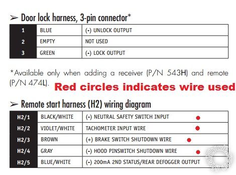

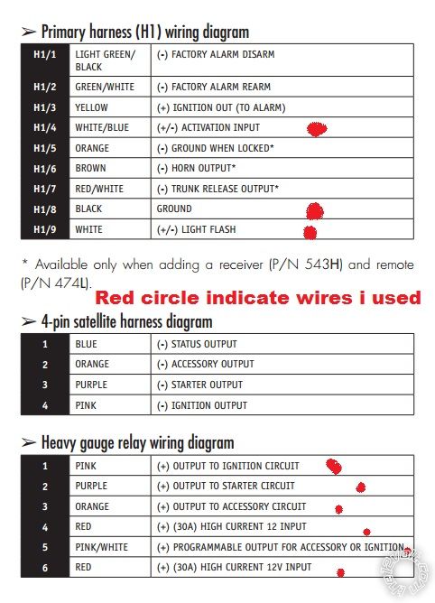

I have looked at other forums post and remote start guides but they all list the same wires and i have made sure there all installed correctly and i have programmed the remote start module to the tach wire. Oh one last thing when i used the remote start module to diagnose why it wont start it blinks three times which indicates low, or no rpm or low battery. I can assure you my battery is fully charged i drive everyday

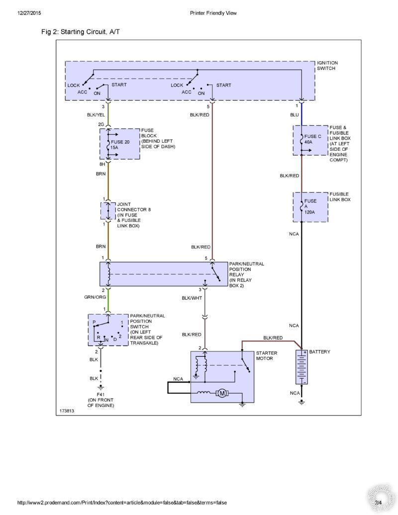

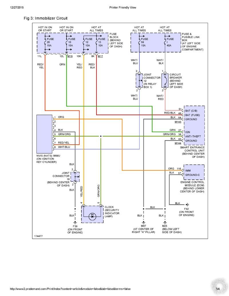

Installed DEI 4003 Car cranks but no start -- posted image.Installed DEI 4003 Car cranks but no start -- posted image.

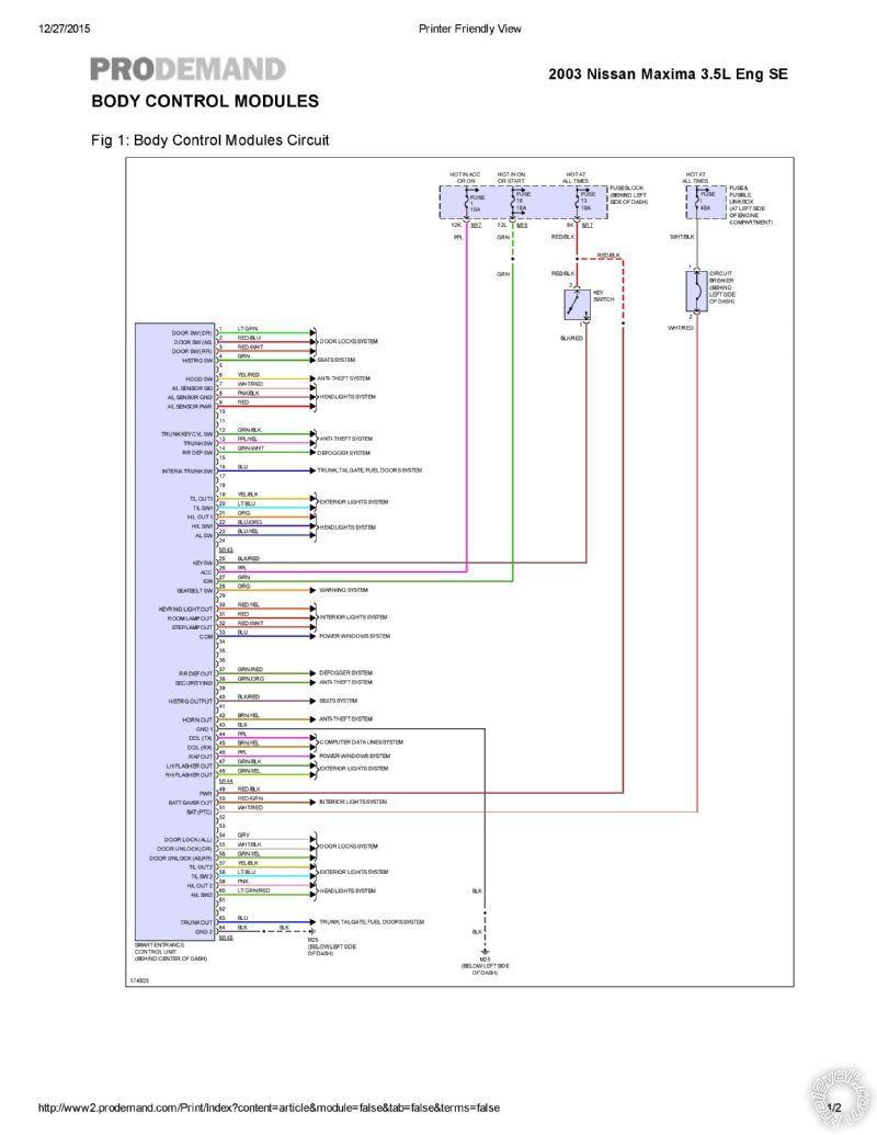

Factory wiring

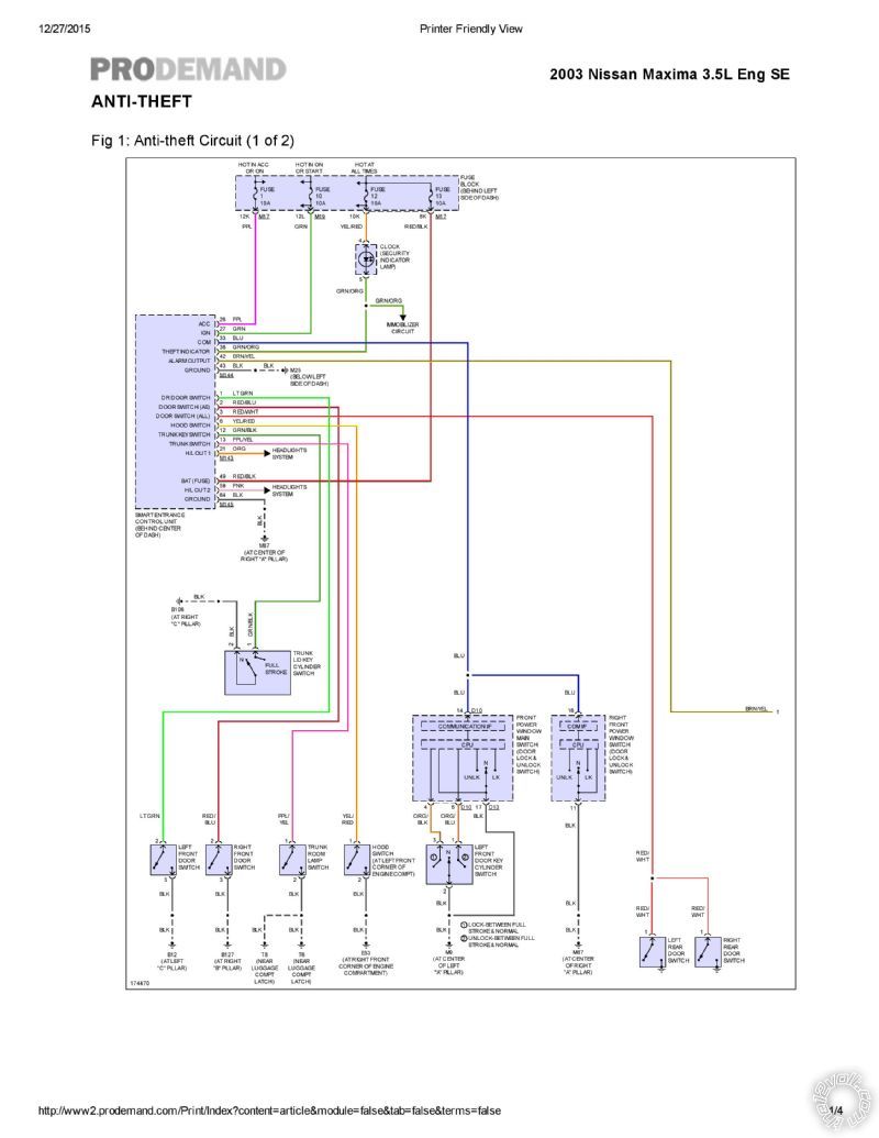

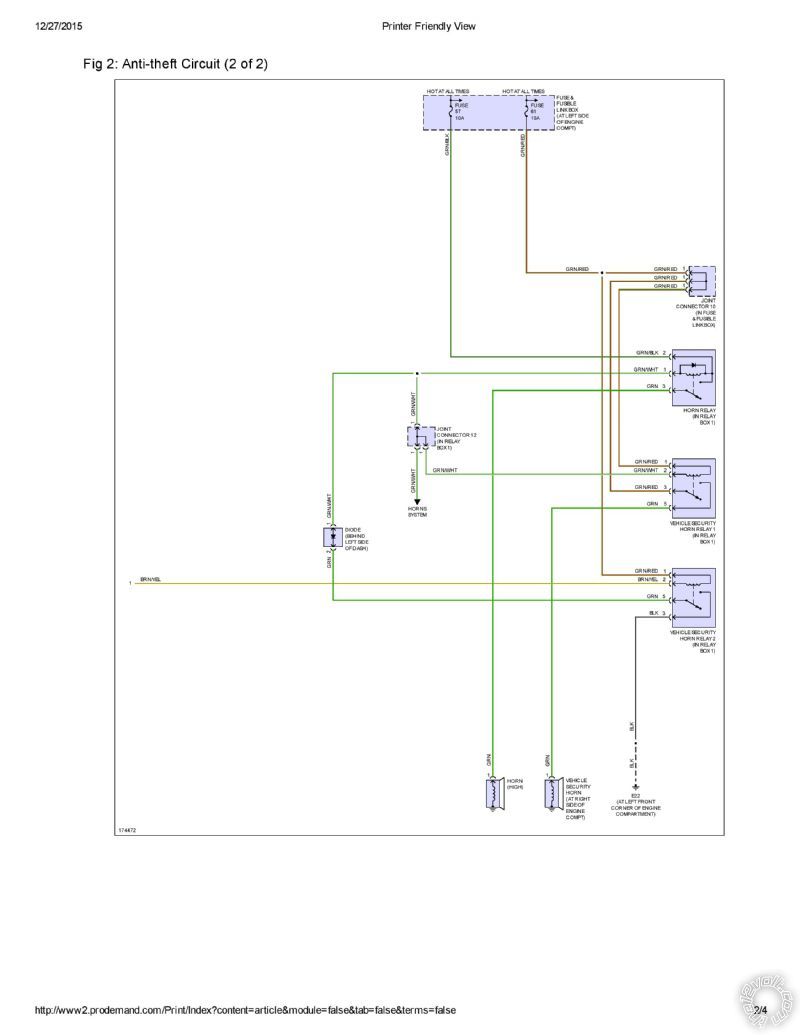

Anti theft

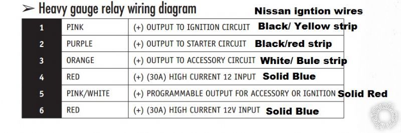

here are the wires i have connected

The second starter wire needs to be hooked up. Also make sure pink/white has been changed to accessory output instead of ignition. And I know you said its set to tach but did you learn tach on the brain?

One curious thing, you didn't mark that you used the factory disarm wire.   Does your car have a security system?   Many Nissans enable a factory security system with lock from the keyfob. The factory key turned in the ignition can override this. Not sure if this is contributing, but many use the lock motor signal for remote start. To rule this out, you could remove the Activation wire and unlock the car. Then tap the activation wire to the correct state (12V or ground, as you have the unit configured) the programmed amount of times to start the car and see if it dies.
