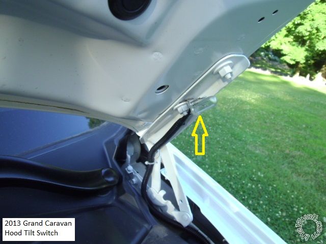

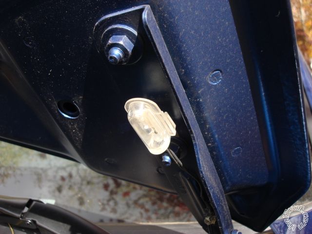

And to add insult to injury, that new hood pin will go bad in a few years, depending on the weather and road salt.  Might think of replacing it with a tilt switch.  They last a lot longer and you don't have to drill any holes.
