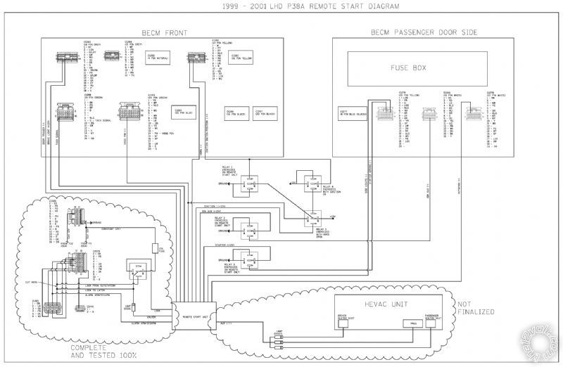

I'm installing a remote start in my 2001 RR.
Remote start make model: Prostart CT-3471TW
I have made a wiring diagram and done most of the install. I used 3 relays for the ignition to convert from positive to negative. Everything went well but I could not enter programming mode. I then found out that the yellow wire needs 12V with ignition on for program mode. I then revised my diagram and could use some input as to whether I am on the right track.
Thanks,
Ray
2001 Range Rover Remote Start -- posted image.
