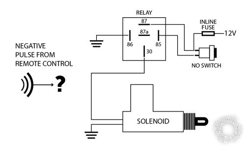

Hello everyone,
I recently installed a custom trunk release system in my Yaris Sol hatchback. Here you can see the scheme of the installation (I think I connected the relay upside down, but it works anyway)
Trunk Release diagram for european Yaris 2009 -- posted image.
I would like to know how can I use 2 consecutive negative pulses from the remote control key to activate the relay of the trunk release?
1 pulse from the remote control unlocks all doors (this is factory default).
I think the solution might be in this diagram but since I'm a newbie I don't know how to use it in my situation.
I appriciate your suggestions, thanks.
Marco

Posted: January 14, 2016 at 5:56 PM / IP Logged Link to Post Post Reply Quote kreg357
You could use a PAC TR-7 module to do this.  Using Feature 14 wiring and programming, you could have the Green (+)
Input wire connected to the Drivers Door Unlock Motor wire.  Program the TR-7 to 2 input pulses within 3 seconds to give
an output.  Connect the Blue (+) output wire to the wire at Relay Pin 85.  *
Here is a link to the PAC TR-7 manual  :  https://www.the12volt.com/installbay/file.asp?ID=1031
Here in the States a PAC TR-7 module goes for $15.  As Mr. Geepherder said, it might be just as easy to get a
aftermarket Remote Start with Keyless Entry system for $50 and have it all on one remote.
* Standard relay convention is Relay Pin 85 gets a (-) input and Relay Pin 86 gets the (+) input.  Your diagram will work
  as long as the relay is not polarity sensitive ( internal coil quenching diode ).

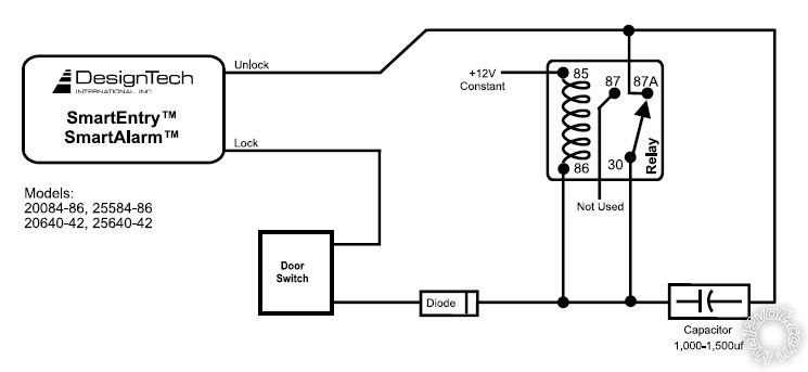

Thanks everyone for the very quick answers!Trunk Release diagram for european Yaris 2009 -- posted image.
Although using an aftermarket remote is the easiest way I would like to find a solution to keep using the toyota remote, and the PAC TR-7 module do exactly what I want, thanks Kreg.
I took also a quick look at Clifford's website, if I'll have to install an aftermarket remote I consider these products.
I search a lot the web about my issue, do you think that this diagram can help in my case?
