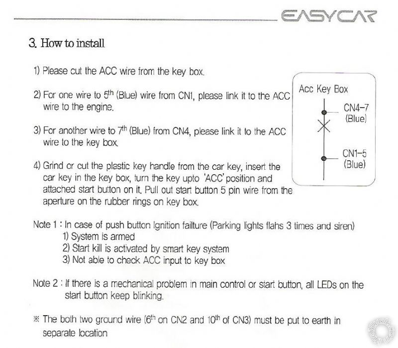

Hi All
I have problem with push button do not start engine and give me ( error 3 door open ) and when I try to start engine from remote I get ( error 6 hood open )
My remote is E772AS with M-7700B unit
My Car Chevrolet Epica 2005
any body fix this problem or any update
Thanks All

This Remote installation Guide
http://www.kw7.net/EasyCar_E772AS_installation_Guide.pdf
almarri
Joined: January 17, 2016
Location: Kuwait
Posted: January 29, 2016 at 1:06 AM / IP Logged Link to Post Post Reply Quote almarri
Now all the remote services are working to the fullest
The problem was that I did not apply this part of the manual
push button does not start engine, easycar E772AS -- posted image.
Thanks for all
