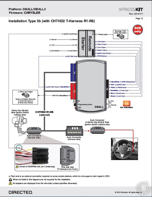

I am install the Python 5303P security system with remote start in my 2007 Chrysler Aspen. As well, I'm using the DBall2 module with the CHTHD2 T-Harness R1-R6. I believe I have all the wiring run correctly so far, but I'm not sure about a couple connections. I was hoping someone could assist me in making the correct connections.
2007 Chrysler Aspen with Pthyon 5303P/Dball2 -- posted image.
I have highlighted the connections I've currently made, but I'm a little confused with the connection going from the Remote Start to the Ignition harness. I used the heavy gauge H/5 wiring, which will go to the Ignition. Then, the DBall2 diagram shows Ignition Input, which I spliced the H/5 wire to make the connection. Is this correct? Finally, I'm confused about the GWR(Status) wiring on the Remote Start module. Can someone tell me which wire is the GWR status? Any help would be greatly appreciated

I have no experience with D2D modules, but the ignition input looks good to me.
The blue status wire is also known as GWR. If you're not connecting the rear defroster, you can also use the blue/white wire (H3/5). I think status (GWR) is the default setting.
Hopefully someone else will correct me if I'm wrong.
