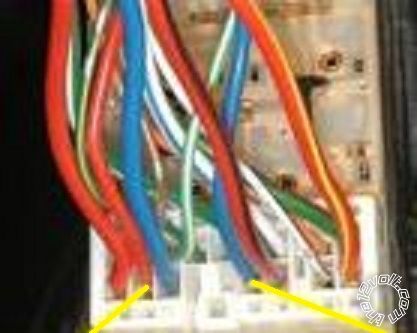

Going with these wires, you would have to program the 4103 to a double unlock pulse.  Here is a photo of the connector
with the Red and Blue wires highlighted :
4103 09 nissan titan -- posted image.

So if I understand correctly I do not need to use the alarm arm and disarm on the RS unit. I use the lock/unlock wires and run them to the red and blue wires above in the power window bundle? How about programing double unlock pulse, how do I go about that?
