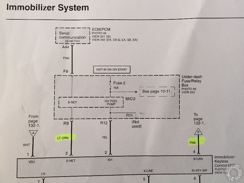

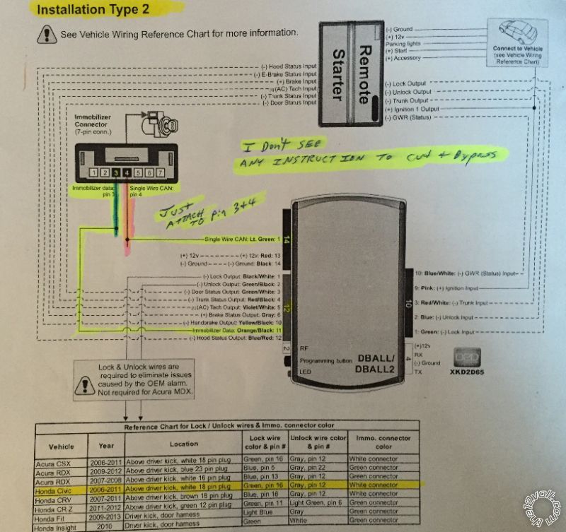

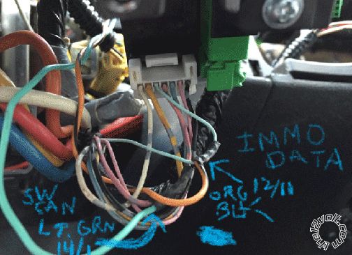

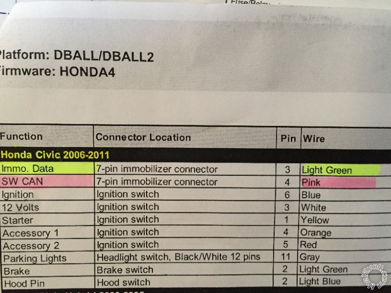

I am using a dball2 to interface a DEI Viper 5301(4x02) remote start in a 2007 Honda Civic Si. After a "successful" XKloader2 flash of the Honda4 3.06 firmware I attempted to install using D2D. Unfortunately, I found that the DBALL2 was not learning the Data or CAN B bus correctly. It would start out as a solid red going to green for maybe one second and the off and the triple red flash. Thinking that maybe D2D was causing some of this I decided to W2W from the Viper 5301 to the DBALL2 and relevant vehicle harness locations. I flashed the DBALL2 again and removed all of the D2D check boxes. Attempting the learning procedure again I saw that I would not receive a green light at all. Instead I just observed the solid red moving to the endless triple flash. The worst part is that if either the CAN B or Data wires are connected the car will not even start with the key.
I am including some images to show my notes and the immobilizer connections. I can't see where I could be going wrong with this. If anyone has an idea I would greatly appreciate any insight.

Your connection points look correct.  The scary thing is that with the DB-ALL2 connected, the Civic won't start with the key.  It's supposed to be very passive with no interference with normal vehicle operation.  Have you tried another DB-ALL2 module?

There is supposed to be a yellow ignition wire in pin 2. But it is orange it is orange in the picture. Are you in the correct plug?

Unless it is yellow and the camera made it look orange.
The colors are correct as you see them. Maybe it is because it is an Si model? The plug should also be green if you went by what you would expect to see, but in this case its white for some reason.
There are only two plugs connected to the immobilizer. At least the white one has 7 pins. The green one which is plugging in vertically has to few to be the correct one.
