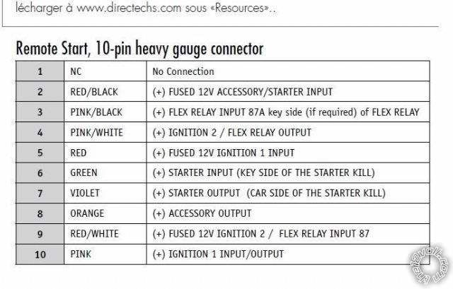

Posted: February 04, 2016 at 9:45 PM / IP Logged Link to Post Post Reply Quote 98sten
09 sierra viper 5706v dball2 install -- posted image.
Herald is the alarm wiring
