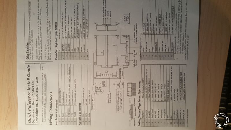

Thanks for the reply.....I did read that before, its much different then this install.
I forgot to mention in the OP that I did flash the Dball2 with the 402.CHRYSLER v5.06.01 firmware. I did program it successfully. Then I stopped myself from going any further because I'm not sure on a few things. The remote start part is whats throwing me.
In the instructions for the Dball2 I looks like all I need to connect on the 5706v side is
10-Pin Connector:
2- RED / BLACK (+) FUSED 12V ACCESSORY/STARTER INPUT--hook up to any 12v constant
10- PINK +IGNITION 1 INPUT/OUTPUT---hook up to pink from harness on the CHTHD1
6-Pin Connector;
2- Black (-) CHASSIS GROUND
Also, confused on the Dball2 instructions for parking lights. pin 8 and 9 get tied together and connected to the same wire? MUX?
2011 Dodge Ram 1500 dball2/5706v -- posted image.

Posted: February 12, 2016 at 7:41 PM / IP Logged Link to Post Post Reply Quote kreg357
Well, not exactly.  I'm not a big Viper user, never used a DB-ALL2, rarely go D2D and never used a T-Harness.  Anyway,
Here are my thoughts.
The Viper needs +12V power.  At a minimum, I would connect :
Main Harness, 6-pin connector, Pin 1 Red (+)12VDC CONSTANT INPUT
Remote Start, 10-pin heavy gauge connector, Pin 5 Red (+) FUSED 12V IGNITION 1 INPUT
and for good measure Pin 2 RED / BLACK (+) FUSED 12V ACCESSORY/STARTER INPUT
Not sure why they do it that way, but you should follow the DB-ALL2's diagram, join the two Parking Light MUX output wires
and connect them to the trucks White Parking Light MUX wire shown in the Pictorial.  A MUX wire, in this application, will
give parking lights with one voltage value, headlights with another and be off with none.  It's just a simple way to provide
different results using one wire.
Additionally, I would ensure the Vipers Parking Light fuse/jumper is set to (+).  You also need to connect the D2D harness
between the Viper and the DB-ALL2,  This handles all the dashed blue lines.

Posted: February 12, 2016 at 10:12 PM / IP Logged Link to Post Post Reply Quote etracyirl
What about 10-pin ignition input/output?
Platinum - Posts: 7,827
Posted: February 13, 2016 at 6:22 AM / IP Logged Link to Post Post Reply Quote kreg357
You already mentioned that wire.  Follow the DB-ALL2 diagram and connect it to the Pink wire in the T-Harness.  We are
going with the Type 1a diagram assuming you have the R7 T-Harness and not the older R1 through R6 T-Harness.
While you believe your install in totally different than the Pictorial, they are very similar.  For that truck there are very few
connections necessary, as follows :
1. Chassis Ground - Viper H1/2
2. Viper Power - H1/1, H3/2 and H3/5 *
3. Parking Lights - DB-ALL2 Red plug Pins 8 & 9 to Parking Light MUX wire
4. RAP - DB-ALL2 Red Plug Pin 10
5, CAN Hi, CAN Lo and Ignition - all handled by the T-Harness to ignition barrel connector
6. Hood Pin - Viper H2/9 to installed, kit supplied, hood pin
* I would combine all these wires into one and leave only the H1/1 fuse.  There will be virtually no current draw from the H3 wires.
In your case there is a D2D harness to connect between the Viper and the DB-ALL2 and the Viper IGN1 wire ( H3/10 ) to
the T-Harness.  The Pictorial shows the RAP Door Trigger wire, the Parking Light MUX wire, a convenient +12V constant
power source wire, the location of the connector for the CAN Hi, CAN Lo & Ignition wires and a convenient firewall pass-
through.
That's pretty much it.  A few Viper programming options need to be changed, a Tach Learn, etc.
Almost forgot, in your case with a Viper alarm system, Viper H1/3 goes to the siren.
