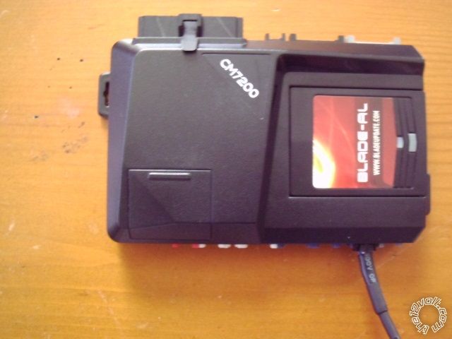

I haven't actually tried an install with this set-up but here is an Omega Blade AL cartridge installed in a Compustar CM7200 module.
Idatalink-omegalink Blade compatibility -- posted image.

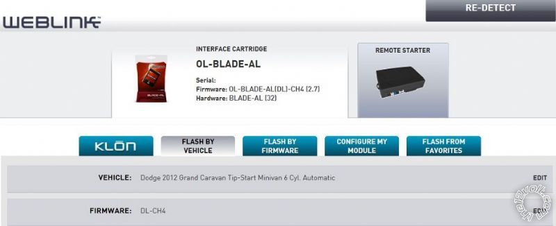

Here is a snip of this setup getting successfully flashed with the latest CH4 firmware ( Ver 1.5 to Ver 2.7 ).
Like I said, I didn't actually install this into a vehicle but it seems to be all set to go with an Omega Blade AL in a Compustar R/S brain.

Understood.  My example is the exact opposite of the OP's question.  I've got an Omega Blade AL in a Compustar CM7200.  Plus I'm not using the iDatalink site nor the Omega site to flash it.  As you mentioned, the ADS AL-CA, FLCAN or OL-MDB-ALL module's are pretty interchangeable, especially if you're like me and go W2W.  Idatalink-omegalink Blade compatibility -- posted image.

So the Idatalink Blade-Al just arrived. I plugged it into an Excalibur 1860 EDPB, plugged my Omegalink Loader in, and it flashed just fine. When you log onto the site it detects the module. This one came up as "COM Blade-Al" lol. Side note...I ordered an Ol-MDB-GM1 the other day, its showed up in an Omegalink box, and the Module had a sticker on it that said Ol-MDB-GM1, but when u remove the sticker the plastic housing has Idatalink stamped into it. I think it's pretty safe to assume it is all the same equipment that 3 different companies slap their logo on and sell as their own.

So I was wrong! Even though the Idatalink module flashed just fine it doesn't work. I kept getting two red flashes, then a blue flash. Then I flashed an Omegalink blade al and it worked flawlessly. I even flashed the Module from the Idatalink website but apparently it doesn't like the Omega brain. Pretty bad that Omega can slap their logo all over Idatalink's products and sell them as their own, yet they make sure unless the blade says Omega on it, it won't work in their brains. Sorry for the bad info guys.
