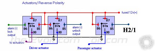

I added the third relay on the diagram, does this look correct?
Progressive door lock -- posted image.
Posted: February 21, 2016 at 9:46 AM / IP Logged Link to Post Post Reply Quote howie ll
Yes but you don't need to connect the R/S since an auto can only be started in N or P.
Your diagram is correct though I would add diodes (1N4004) as protection across the relay coils, band of diode to 86 in right hand pair, 85 on left hand relay.
