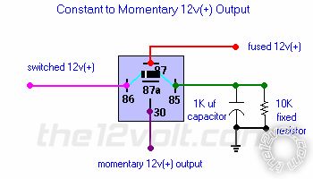

Another thought I had was to just use relays. Considering that this is a gen 8 civic is this as good an option as using the window modules? The one advantage to using a module I saw was the ability to vent the windows. Is this possible and/or cost effective to do with relays.
Regarding relays I was thinking of using the following relay design.
1)Pulsed...for open or close of sunroof
Window/Sunroof modules for 07 Civic With DEI R/S -- posted image.
