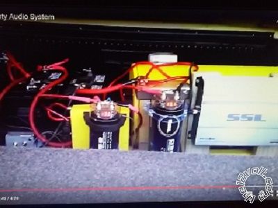

All goes silent at higher volumes not clipping -- posted image.
Just sharing a pic of what's in the bed of my Mazda.
