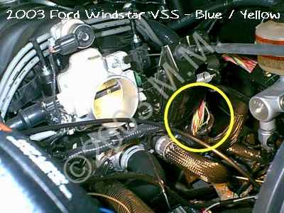

Here's where I picked it up. It will be a blue / YELLOW wire in the harness running up near the throttle body that goes up and over the engine. There will be more than one blue / YELLOW in there from what I remember. You can also get it directly from the plug, but the plug is WAY down on the tranny and a pain to get at. It's easy to mistake it for another plug that has a GREEN / WHITE in it. This is the wrong plug go about 2 feet to the left for the right one. But yeah I wouldn't waste your time connecting at the plug just slit that harness open and find the blue / YELLOW. I'll attach a pic and see if it works. Good luck let me know if you have any other questions.
