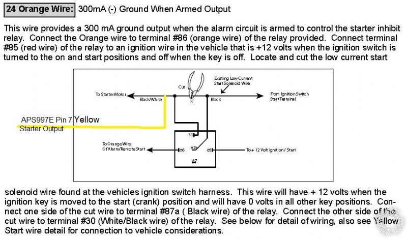

I'm guessing that the APS997E's thick Yellow Starter wire is connected to the wrong side of the Starter Kill relay's cut on the vehicles starter wire.
See diagram below :
Aps997E remote starting when armed -- posted image.
thick Yellow Starter Output wire :
NOTE: This wire must be connected to the vehicle side of the starter cut relay (when used).

Yes.  When the APS997E is not armed the relay will not open the Starter wire during a start up attempt.  If the APS997E Starter wire is connected "wrong side" of the interrupted vehicle Starter wire and the APS997E is armed, the Starter signal from the key switch or the APS997E can't get through the relay to the cars starter circuit and engage the starter motor.

Awesome. Got a chance to dive into it today and that was the issue. Thank you for your assistance.
