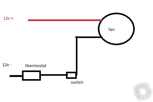

you would wire the manual override on/off switch between the automatic thermostat and the fan. like this if you only want the switch to manually override to turn off...
Electric Fan Wiring -- posted image.
if you want an override to achieve on AND off you need to add a relay

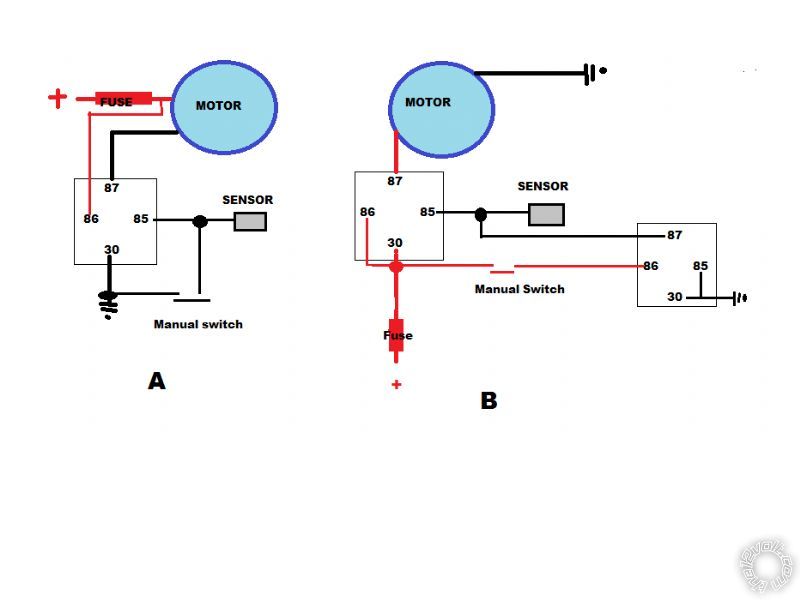

Gary Sather
Posted: May 24, 2016 at 1:46 PM / IP Logged Link to Post Post Reply Quote howie ll
This is nearer to the OEM set-up, diagram A uses a simple on-off switch, B an illuminated.
There is one mistake I've just realised, in B 12V+ source for the switch and 86 on the far right relay should be ignition not constant otherwise the fan could be left on permanently. fan_over_ride..png
Note, this way you can over-ride at any time. The relays allow you to use thinner wires and lower current capacity switches.
