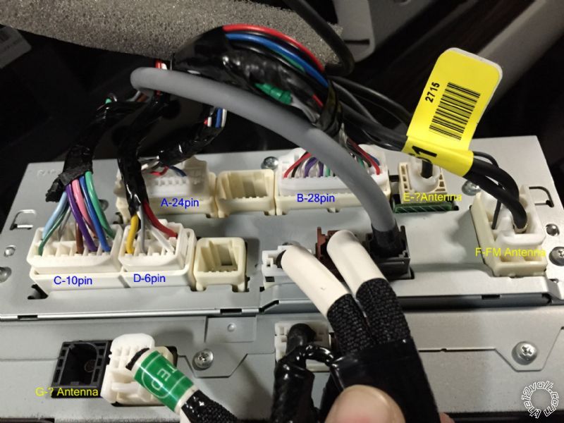

Hi,
I was trying to figure out what each connector does in the 2015 TOYOTA SIENNA head unit. Can anybody help? Thanks!
A-24pin:
B-28pin:
C-10pin:
D-6pin:
E Antenna: My guess is GPS, but not sure.
F Antenna: My guess is FM Radio.
G Antenna: My guess is XM Radio, but not sure.

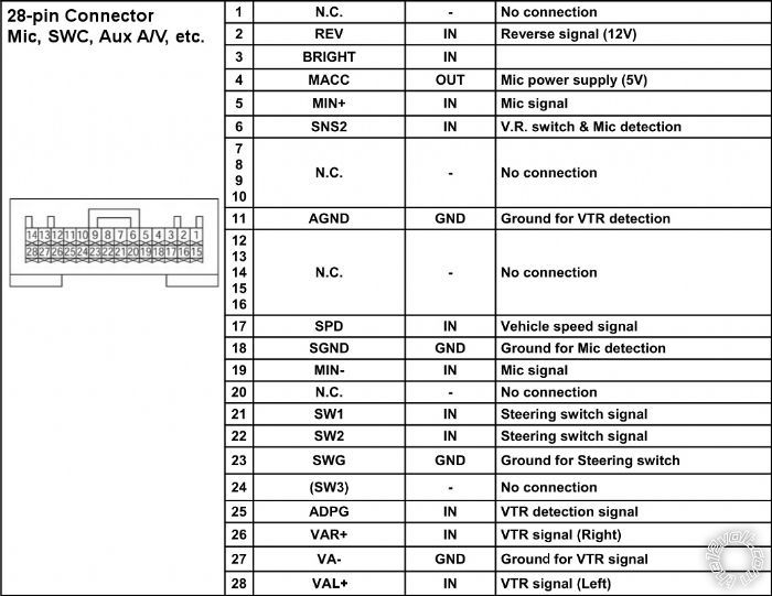

2015 Sienna Head Unit Wiring -- posted image.
On TOYOTA vehicles, there is a 28-pin connector to the factory radio. If we were to replace the factory radio with a aftermarket product (say, Kenwood), which wires on the 28-pin we need to connect?
It looks like aftermarket radios do not have corresponding wires for all the TOYOTA 28-pins. Thanks!

FM antenna = Metra 40LX10 or 40LX11 Look for those 2 on their website they do have pictures.
