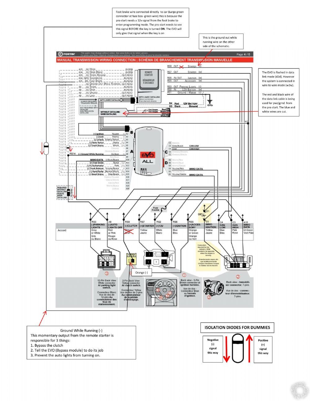

I am fairly new with remote starters and have a couple questions before I get started. I am using a Pro start CT-3271 with an evo-all bypass flashed with firmware version 79.13. I want to use the data link cable option. Accord is manual transmission.
The EVO wiring diagram includes the required wires for the remote start. I have hooked up everything in the EVO diagram and nothing happens when I plug in the remote start (parking lights should flash) this is before programing the bypass module.
The pro Start instructions say the module will look for the handbrake(-), door pin(-) and tach connection, However the EVO instructions don't say to hook those up when using the data link cable.
Please see attached image for the connections I have made. (EVO Wiring Diagram for manual)
Thanks very much for anyone who can help

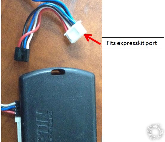

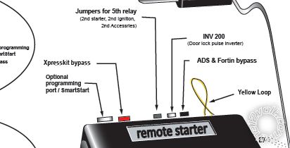

1. As for D2D the EVO has been flashed with the F3 option. The CT-3271 Instructions say it ONLY supports 2 way communication with Xpresskit.Only 1 way with Fortin... I notice the EVO data link cable has 2 connectors on one end and one will fit the expresskit port on the R/S. Would it make sense to plug the EVO into the expresskit port for 2 way communication? See Below Pics..

1: You have the correct firmware flashed on to the EVO-ALL. For all intents and purposes, it will communicate with the
    CT-3271 as a XpressKit module using DBI D2D protocol. I believe the CT-3271 will accept the EVO-ALL as a XpressKit
    bypass module and allow 2 way data transfer. As you mentioned, you will connect the EVO-ALL to the CT-3271's DBI
    D2D port using the correct connector on the supplied harness.

Hello I wanted to post a schematic of how I finally ended up wiring this. It might help someone out with the same car.
It has been working great for a year and I again want to say thanks to all that helped.
Pro-start CT-3271 remote start with Fortin Evo-All bypass.
2010 Accord Manual
