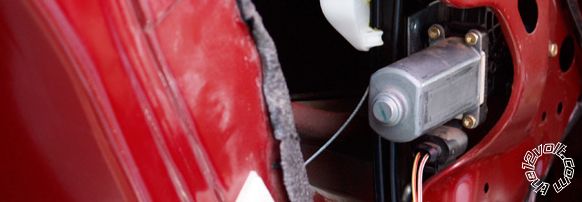

At the passenger side I've got power to the motor.
Both when I press the passenger side switch up (11.8V) and down (11.8V). And like 13,8 V when the engine is running. Se pic.
Chevrolet mini van power windows malfunction. -- posted image.
