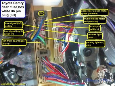

here you go:
2015 (through 2016) Toyota Camry      DirectWire Vehicle Information

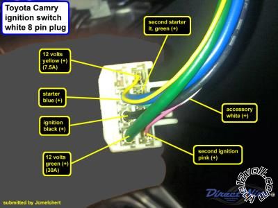

12 Volts     green (30A)     +     ignition switch, white 8 pin plug, pin 5
Second 12 Volts     yellow (7.5A)     +     ignition switch, white 8 pin plug, pin 4
Starter     blue     +     ignition switch, white 8 pin plug, pin 7
Second Starter     lt. green     +     ignition switch, white 8 pin plug, pin 3
Ignition     black     +     ignition switch, white 8 pin plug, pin 6
Second Ignition     pink     +     ignition switch, white 8 pin plug, pin 1

Accessory     white     +     ignition switch, white 8 pin plug, pin 2

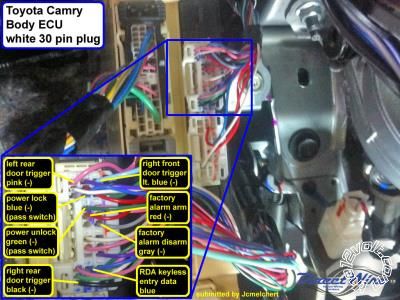

Keysense     green     -     Body ECU on dash fuse box, white 30 pin plug, pin 17

Power Lock     blue (passenger door switch)     -     Body ECU on dash fuse box, white 30 pin plug, pin 9
Power Unlock     green (passenger door switch)     -     Body ECU on dash fuse box, white 30 pin plug, pin 10

Parking Lights (-)     black     -     Body ECU on dash fuse box, white 30 pin plug, pin 30
Parking Lights (+)     pink     +     dash fuse box, white 36 pin plug (3C), pin 5
Hazards     white     -     A/C control assembly, black 16 pin plug, pin 4
Turn Signal (Left)     yellow     +     dash fuse box, white 36 pin plug (3C), pin 22
Turn Signal (Right)     green     +     dash fuse box, white 36 pin plug (3C), pin 19
Headlight     pink     -     Body ECU on dash fuse box, white 30 pin plug, pin 29
AutoLights     green (interrupt to turn off autolights)     -     Body ECU on dash fuse box, wht 30 pin plug, pin 28
Reverse Light     pink     +     dash fuse box, white 36 pin plug (3C), pin 7
Left Front Door Trigger     blue     -     dash fuse box, white 36 pin plug (3C), pin 15
Right Front Door Trigger     lt. blue     -     Body ECU on dash fuse box, wht 30 pin plug, pin 19
Left Rear Door Trigger     pink     -     Body ECU on dash fuse box, wht 30 pin plug, pin 1
Right Rear Door Trigger     black     -     Body ECU on dash fuse box, wht 30 pin plug, pin 6

Trunk/Hatch Pin     white     -     dash fuse box, white 36 pin plug (3C), pin 9

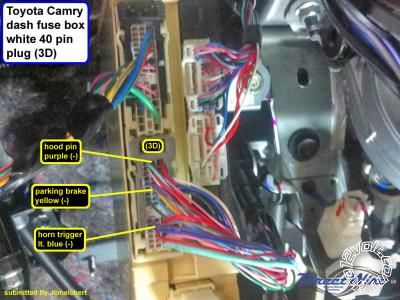

Hood Pin     purple     -     dash fuse box, white 40 pin plug (3D), pin 25

Trunk Release Motor     red     5 wire     dash fuse box, white 36 pin plug (3C), pin 10

Factory Alarm Arm     red (driver door key lock)     -     Body ECU on dash fuse box, white 30 pin plug, pin 11
Factory Alarm Disarm     gray (driver door key unlock)     double -     Body ECU on dash fuse box, white 30 pin plug, pin 24

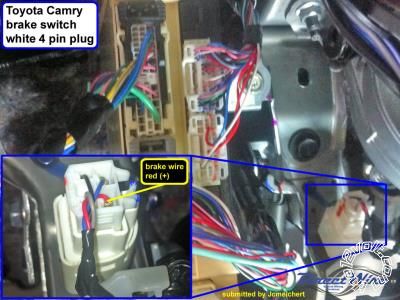

Brake Wire     red     +     brake switch, white 4 pin plug, pin 1
Parking Brake     yellow     -     dash fuse box, white 40 pin plug (3D), pin 20
Horn Trigger     lt. blue     -     dash fuse box, white 40 pin plug (3D), pin 15

I'm doing a 2016 Camry now (non smart key). Only difference thus far is that the white accessory wire does work heat,a/c. Radio works lol.
maryland33
Member - Posts: 33
Joined: February 05, 2009
Location: Maryland, United States
Posted: December 13, 2016 at 5:01 PM / IP Logged
Edit... Heat or ac does NOT work with the white accessory wire. Sorry,still working it out
maryland33
Member - Posts: 33
Posted: December 14, 2016 at 11:30 AM / IP Logged
Pink wire (2nd ignition) @ ignition switch harness did the trick. That's what I get for being outta the game for so long lol. Hope this helps someone out there. Thanks Tonanzith!!!

Can Bus Sw     blue (RDA keyless data); gray (SIL immobiliz comm)     data     Body ECU, wht 30 pin plug, pin 16; data link conn, wh 16 pin plg, pin 7
Dome Supervision     lt. green     -     dash fuse box, rear, white 40 pin plug (3B), pin 35

2015 Toyota Camry Remote Start/Security Wiring -- posted image.
