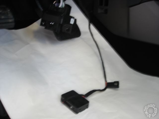

* Interesting point : The ADS AL-CA bypass module install on a newer F150 for 3 x Lock stand-alone operation is so simple ( like 30 minutes, including module flash, start to finish ) that I find time to add a fuse to the module which isn't shown in the iDatalink install guide. Is a Starter Kill relay a bad idea? -- posted image.
