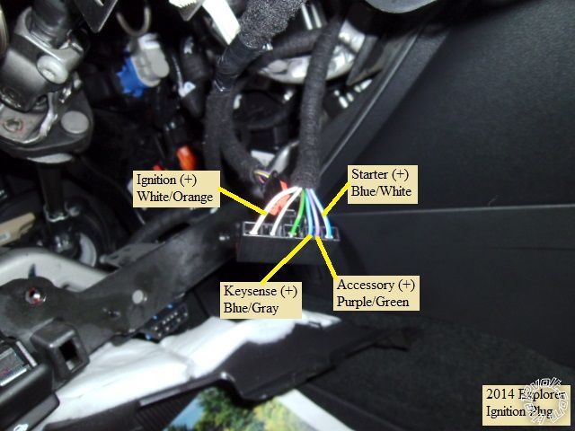

As lurch228 says, the Ignition connector your are looking for is at the ignition switch. One thing
to mention, the cars ignition wires are not the same thick 12 gauge wires that the Viper has on H3.
They are much thinner, like 18 gauge. Here is a photo of these wires from an Explorer, yours should
be similar :
2014 Police Interceptor Sedan. aka Taurus -- posted image.

Thanks! But CRAP! Because I tried for about an hour or 2 to get to the back of the cylinder, and was completely unable, due to the way it's mounted on the Police version of the Taurus. I'll try to get pictures if I can today. On the civilian models, I believe, the cylinder is mounted on the steering column. On the police it's mounted on the dash, and to remove it would require taking apart the whole dash. I may have to follow that fabric tape covered bundle of wires and make sure all the ones I need show up lower down.

I believe the Explorers' ignition cylinder is in the dash to the right of the steering column, too. After you remove the lower dash trim panel, you can blindly reach behind the panel and unplug that connector from the ignition switch. It's the transponder plug ( that you don't have ) that's a PITA to get at.
