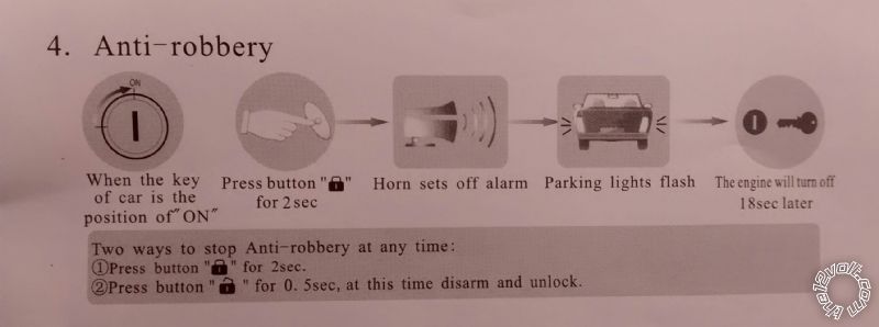

is an alarm china Cardot, if remotely turn on and off perfect.
the the problem is when I want to turn it off with the key in ON.
Shutdown remote with key on -- posted image.

As for shutdown the (+)brown brake input needs to be hooked up to the brake pedal wire that test positive when the brake pedal is pushed (applied )which shuts down the R/S. Then when you hit the brake and Turn off key engine will shut down.

1) I do not understand where this The (-) remote start bypass output
   wire. in the car
2)only need to enable this feature anti-robbery.
in case steal my car driving it can turn it shutdown remote.
so far only I manage to turn on and off remote keyless
insert the key to on and then can't turn off in 18 seconds
the lights on and the siren but not shutdown
That's what the brake input wire does when hooked to vehicle brake pedal (+) wire. This needs to be used to shut off remote start, otherwise will not shutdown when turning off key with short trips until set time runs out. Vehicle will continue to run when R/S is used and key is turned to run after brake has been pushed and 18 seconds has passed.
If you want to shut down the vehicle with the key in the on position you will need to interrupt the ignition wire with the Starter Killer relay.
