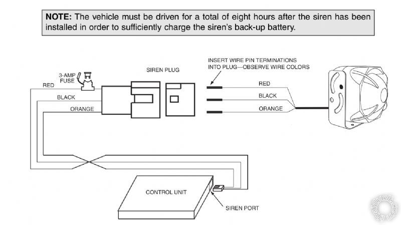

Posted: August 25, 2016 at 3:53 PM / IP Logged
Old Viper 460xv Brown Wire, DEI 516U Voice Module -- posted image.
The siren has its own dedicated plug on the main control box,the brown - is not connected to anything,the image above is is what I have.i am hoping that if I diode protect the orange and connect to the 516u brown with a relay it should work.
