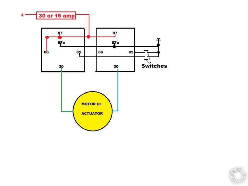

i have a project car that im working on and i want to add push button switches for the windows and door locks. Can anyone tell me whats the proper way to wire and fuse the relays?
Posted: August 27, 2016 at 10:37 AM / IP Logged Link to Post Post Reply Quote howie ll
Try this:-
Please note this applies to ONE window, you will need two of these for two windows etc.
For the locks, above will suffice, join the motor wires.
Note, the higher fuse for 2 windows, the lower fuse for two locks.
Ground in the body, NOT the door.
Out of interest you'd be better off using a proprietary lock relay/timer such as SPAL or DAV or even complete kit, this gives you an option to lock/unlock from the driver's door.

Posted: August 27, 2016 at 8:41 PM / IP Logged Link to Post Post Reply Quote i am an idiot
You need power on terminal 86 of both relays. Howie's picture is missing a red line.
