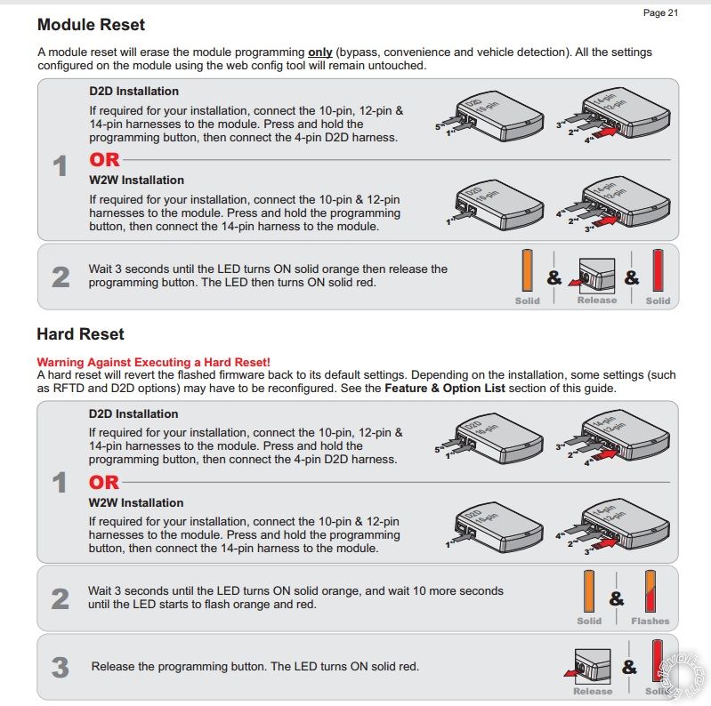

I tried that but its impossible to tell if I reset it correctly since the Dball2 isn't lighting up. I took out the data link, pressed and held the button, installed the data link while holding and the Dball2 didn't flash red or orange or anything at all. I know when I installed it, it flashed and worked. Im not sure if the Dball went bad or what.
lurch228
Silver - Posts: 1,338
Joined: August 08, 2012
Posted: September 07, 2016 at 9:30 PM / IP Logged Link to Post Post Reply Quote lurch228
If it won't do a module reset then a hard reset is next.
This is the install guide that you will need to reset and reprogram it.
DBALL2 Install
Once you reset it you will need to reprogram it to vehicle. If you hard reset it you will need to set it back up from scratch and then program it to vehicle again.
If it won't do either reset then replace it.

Perfect I can't wait to try this tomorrow, if I hard reset and according to the beautiful document you set forth, it says it will revert the flashed firmware, does that mean I have to reflash the bypass with the jeep settings or it reverts back to the jeep settings that was originally flashed?
lurch228
Posted: September 07, 2016 at 9:57 PM / IP Logged Link to Post Post Reply Quote lurch228
IT means that it will be at the default Jeep settings. Any Programmed D2D settings that were selected in the VIP flash pages prior to Flashing could be lost and would need to be reelected and re-flashed with the xkloader2.
If you didn't select or change any of these (Default Options) in the VIP Web interface prior to flashing with the xkloader2 then you don't need to worry about that. But you can make any of these settings changes needed after flashing for you setup. These options are on page 22 of the install that I linked to.
