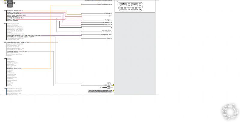

hello all, i got a 2003 cavalier automatic. according to the wiring diagram for my car for the idatalink HC2352AC it dosnt show that i need to hook up any door lock or trunk release wires to work...this correct? i want to have remote start with keyless entry and trunk release. also it shows 2 accessories connections 1 and 2 can i just wire them to the same accessory or what? here is a pic of the idata link wiring diagram im referring to:

i would also like to add that im auto mechanic by trade though i dont have any experience with car starters is all and this specific remote start system looks quite simple to install myself if this is all that needs to be wired in.

hey I'm pretty sure the door locks are controlled by data the one data wire you connect on the old 2 to control door locks, truck and the Immobilizer bypass,

Posted: September 20, 2016 at 4:06 PM / IP Logged Link to Post Post Reply Quote bogucki
no do not connect the two accessory wires together chey has separated them for a reason, you will need to use a relay to isolate and connect the second accessory wire

Posted: September 20, 2016 at 4:11 PM / IP Logged Link to Post Post Reply Quote bogucki
i was just looking at the datalink install guide and is looks like they give you a 2nd accessory wire to use in the m1 heavy gauge connector ( pin 4 pink/white wire ) no relay needed

Posted: September 20, 2016 at 5:56 PM / IP Logged Link to Post Post Reply Quote scypheroth
sooo #1 orange accessory i hook up to the orange accessory wire on the ignition switch harness and the 2nd accessory wire 2 pink/white to the 2nd accessory wire brown off the ignition harness also? referring to this guild:
