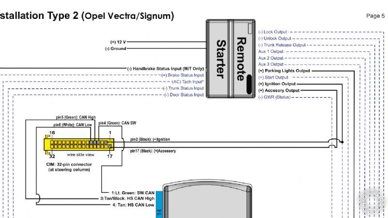

lurch228
Silver - Posts: 1,338
Joined: August 08, 2012
Posted: September 24, 2016 at 8:52 PM / IP Logged Link to Post Post Reply Quote lurch228
Your missing some connections between the R/S and the vehicle, "ACC" for sure but can't get my hands on a wiring list for the vehicle here in the U.S. So can't say for sure if there are any IGN2 ACC2 or Keysense requirements that need to be meet.

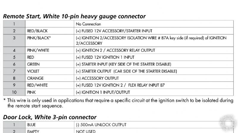

chrisj000
Member - Posts: 38
Joined: August 24, 2016
Posted: September 25, 2016 at 4:06 AM / IP Logged Link to Post Post Reply Quote chrisj000
Dball2 key programming problem -- posted image.
chrisj000
Member - Posts: 38
Posted: September 25, 2016 at 4:10 AM / IP Logged Link to Post Post Reply Quote chrisj000
Hope this helps
I've connected the violet wire to ignition
The pink is connected to accessory
lurch228
Posted: September 25, 2016 at 4:15 AM / IP Logged Link to Post Post Reply Quote lurch228
That is only the required connections to work with the bypass not the vehicle side wire colors and connections to complete the install to the R/S that don't involve the bypass that need to be powered like "ACC", Keysense, "IGN2", "ACC2" if the exist and are required or not.
chrisj000
Member - Posts: 38
Posted: September 25, 2016 at 4:48 AM / IP Logged Link to Post Post Reply Quote chrisj000
I think I know where I've made the mistake the violet I've connected is the starter,on my model the stater is activated by can bus.thr pink I've connected to acc is the viper ingnition input/output so am going to swap this to where the violet is.there is an orange wire that's described as acc + output so I'm going to connect that.does this sound right.cant do it until later on today as I'm at work but hopefully that's where the problem lies.
