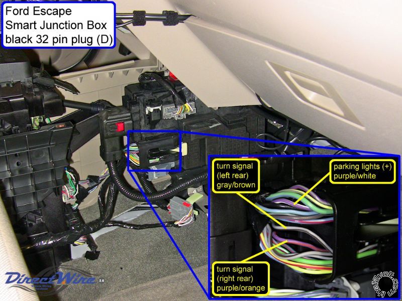

Also, I cannot find a proper parking light wire. The violet/white wire in driver kick panel that wiring guides list doesn't show 12v resting or with parking lights on. I tried wiring up at the switch into a violet/gray wire that shows 12v with lights on but the system doesn't have any activity on the lights with this wire.

2008 Escape DBALL2 Programming Issues -- posted image.
here is a pic of where the + park light wire is ( test wire first )
as to programming the Dball2 i would check that the rx and tx wires are connected properly
then i would reset the dball then try to program again but in the last step is says to jump power to the ign wire NOT acc wire and in type one is says not to remote start the car, just jump power to ign wire

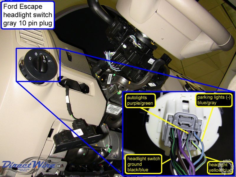

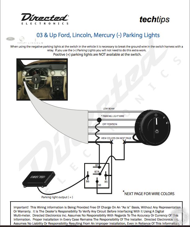

you can also use the - parking light wire at the switch but you will need a relay see pic.
+ parking light IS NOT AVAILABLE AT THE SWITCH 2008 Escape DBALL2 Programming Issues -- posted image.

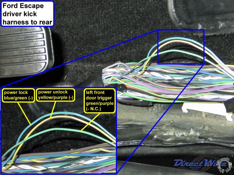

Is there any chance the driver door trigger wire that needs to be cut and interuppted with the RAP on/RAP off wires can be to blame? I couldn't find a Gray/Violet wire that showed +12v with the driver door open as wiring charts say but I did find a GREEN/ Violet wire that does so I cut and wired into that one. This wire was on the bundle of wires coming directly from the drivers door. Also I couldn't tell if it mattered which RAP wire from the DBALL2 connected to which end of the cut door trigger wire.

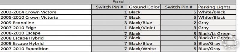

What are these wiring colors referring to? 2008 Escape DBALL2 Programming Issues -- posted image.
ebnub
Member - Posts: 27
Joined: December 17, 2010
Posted: September 30, 2016 at 9:13 AM / IP Logged Link to Post Post Reply Quote ebnub
Oh, parking lights switch. Whoops.

the wire chart is to show what wire is ground if using the - parking light with relay at switch
the door pin is a - trigger not positive, who flashed the dball2 you should ask them if they can do the key2go its a easer way to program the dball but you would need to make two trips to the store that sold it to you, also the rap wire should not effect program it's used to turn off the radio and accessories if you remote shutdown the car.
