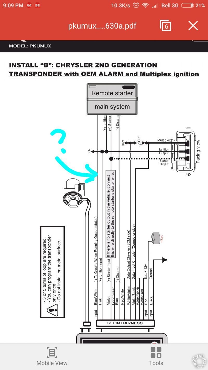

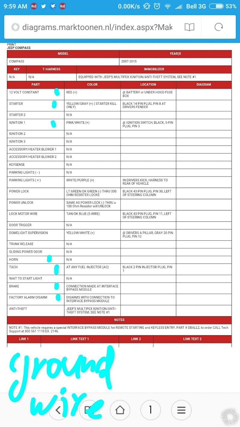

Hi,
I connectd the wires by the installment instruction the seller sended to me. Unfortunately it still can't work. When i pushed the * button, most of the time, it can't crank the engine, sometimes it crank but less than one second engine stoppd.
I tried the Tach Learning and took several turns of loop most of the time it can succeeded to crank the engine,but next time i tried to remote start the engine,it would failed.
I tried to perform shutdown diagnostics, it show 3 flashes. I checked the tach wire have signal and I also tried to program the Engine checking option1 2 3 4 I have tried, but the problem didn't solved.
I have confused about the wire(ground when running output) ,which wire do it connect to the remote starter? Can you give me a details about it?
After all of that, is there any wrong with the bypass?
looking forward to your respond .

Jeep Compass 2009, Avital 4103 +PK3 bypass -- posted image.Jeep Compass 2009, Avital 4103 +PK3 bypass -- posted image.
that are the wires installment

Connect to the Avital 4-pin satellite harness diagram
1 BLUE STATUS OUTPUT to The PK3+ Input Blue/White.
