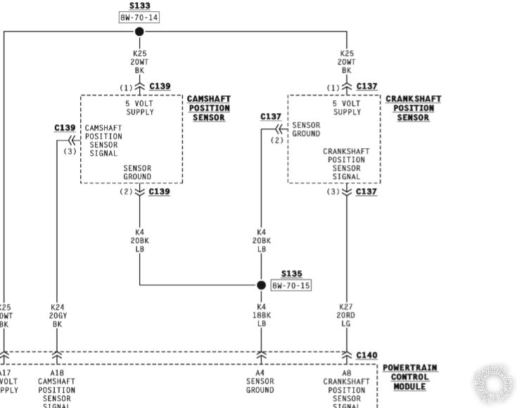

I found this on the net.
We have a 3 wire-tail connected to the distributor
according to this diagram:
a)5 volt supply
b)camshaft position sensor signal
c)ground signal
from which one could i take the rpm signal? Could i identify it with a multimeter?

You need a signal wire, the listing says Dark Blue/ Gray and your diagram says Gray and Black which is the signal. Either signal will work from your diagram just make sure it's protected from the elements once connected.
