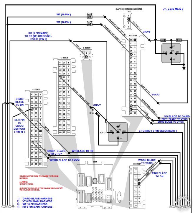

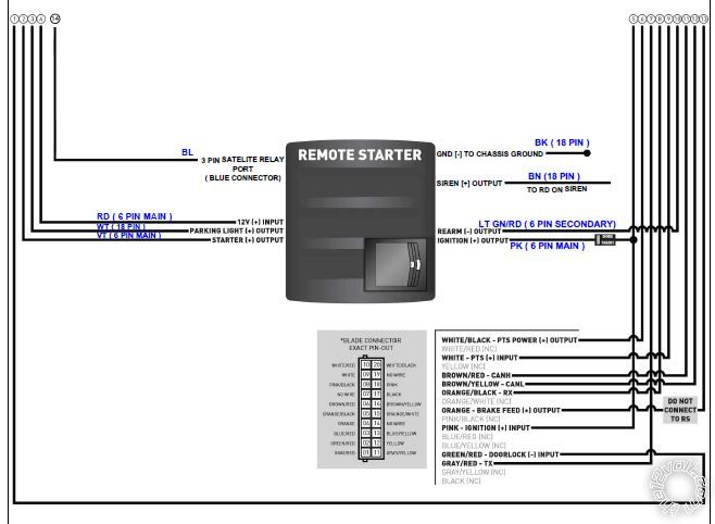

I'm doing the initial programming for this Omega-Excalibur install and I get the solid red light, then it flashes red (repeating 4 flash sequence.)

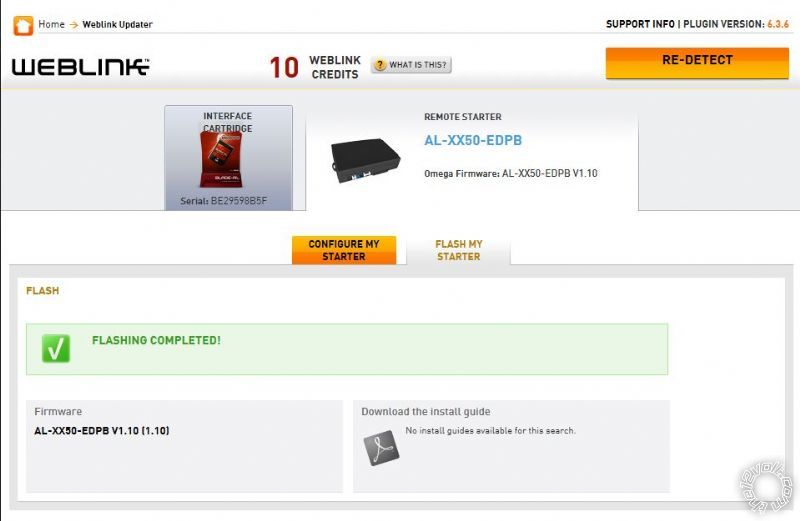

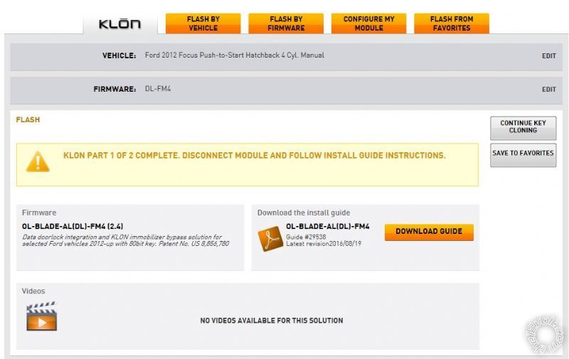

My connections are below, the install manual only says flashing red "missing/wrong information from firmware or vehicle." I've included screen shots of my r/s firmware and blade firmware as well as my wiring connections/guide.
What am I doing wrong?
(I've double checked my key on B+ & Ground, and that I have good Rx-Tx-CanH-CanL connections))

Update:
I was able to program the key successfully and get the flashing blue led! Figured out what I was doing wrong, when it says to insert key fob into steering column, do it.
New problem, after programming both transmitters & programming the installer features, (manual transmission, Data Tach,) I can't get remote start to fuction. I do the shutdown procedure but the valet status led does not turn green and pressing the lock button after exiting the car doesn't do anything. Also, the Blade led flashes red in a 6 pulse sequence.
