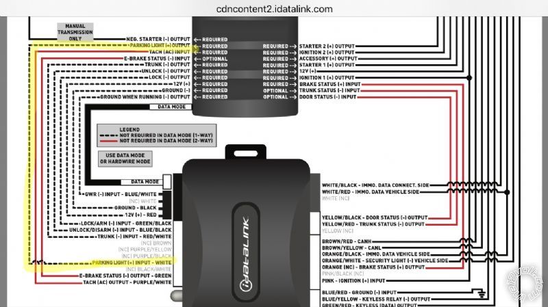

Viper 5606v in 2015 Subaru Forester -- posted image.
The light output from the viper 5606v goes into the idatalink bypass but the bypass does not appear to control the parking lights. Can anyone confirm if the firmware has an issue or perhaps just doesn't support this feature?
I think I may end up hardwiring the parking lights. The idatalink folks don't seem to want to give any info if your not a dealer....

Issue solved, changed over from W2W to D2D all works perfect now... factory fob even works to arm and disarm the viper system... must say I'm very pleased now!!!
