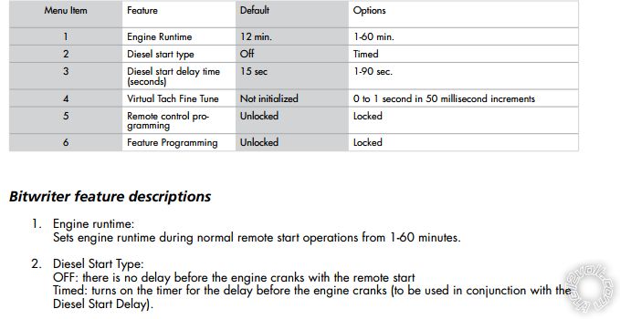

Does anyone know if the Diesel Start Type has anything to do with it. Looks like it cannot be changed without a Bitwriter?
4105v on 2005 ford diesel -- posted image.
