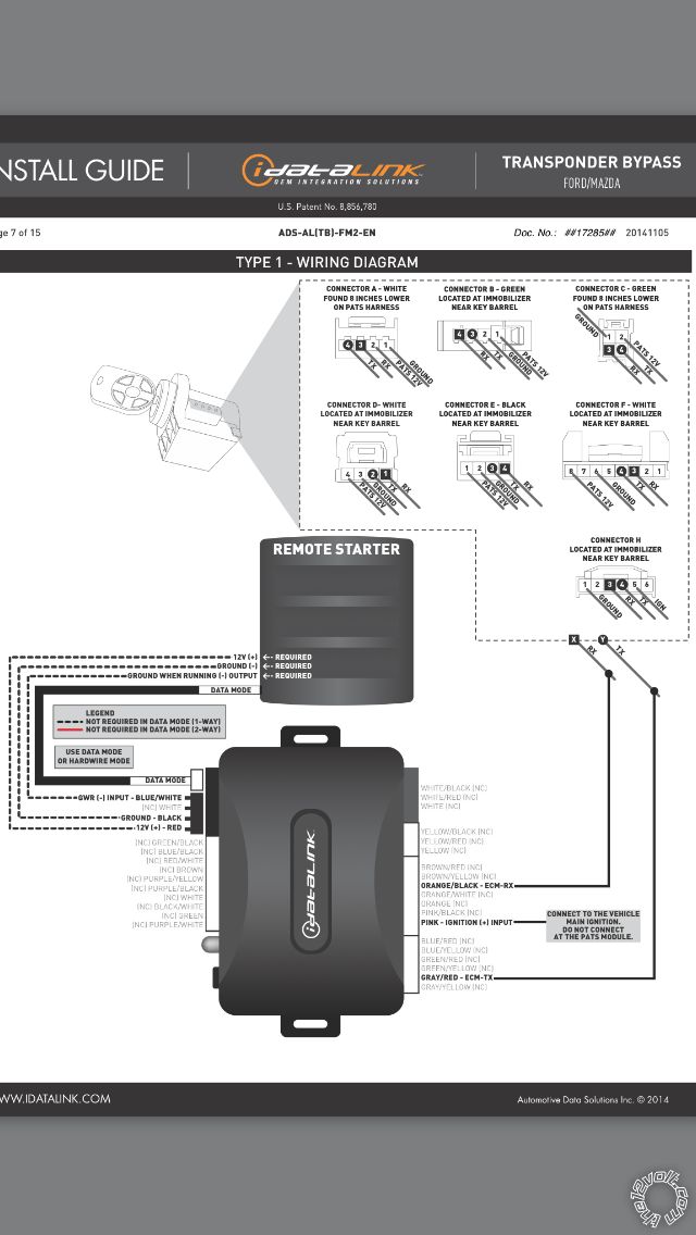

Hi I'm new to this page and I'm going to attempt to install my own remote start so any help would be appreciated. I bought a viper 4105v with a ALCA bypass, according to this diagram if I use the D2D cable it Should control door locks right? So all I need to wire up from the remote start would be the heavy gauge wires like
Red-12v
Pink/white- Second ignition
Red-12v
Orange-accessory
Purple- starter
Pink- primary ignition
And the D2D cable should control everything else? I also ordered the cable to flash the ALCA
Thanks in advance. 2001 Ford F-150, viper 4105v -- posted image.

It probably will not. The web site only shows it doing the Immobilizer Bypass.
Most of the older ford I have done, I have always had to hard wire most everything.
The ALCA might be a bit of overkill since it will probably only do the Bypass.
Link to Kreg357 F150 Install Pictorial:
https://www.the12volt.com/installbay/forum_posts.asp?tid=134275
