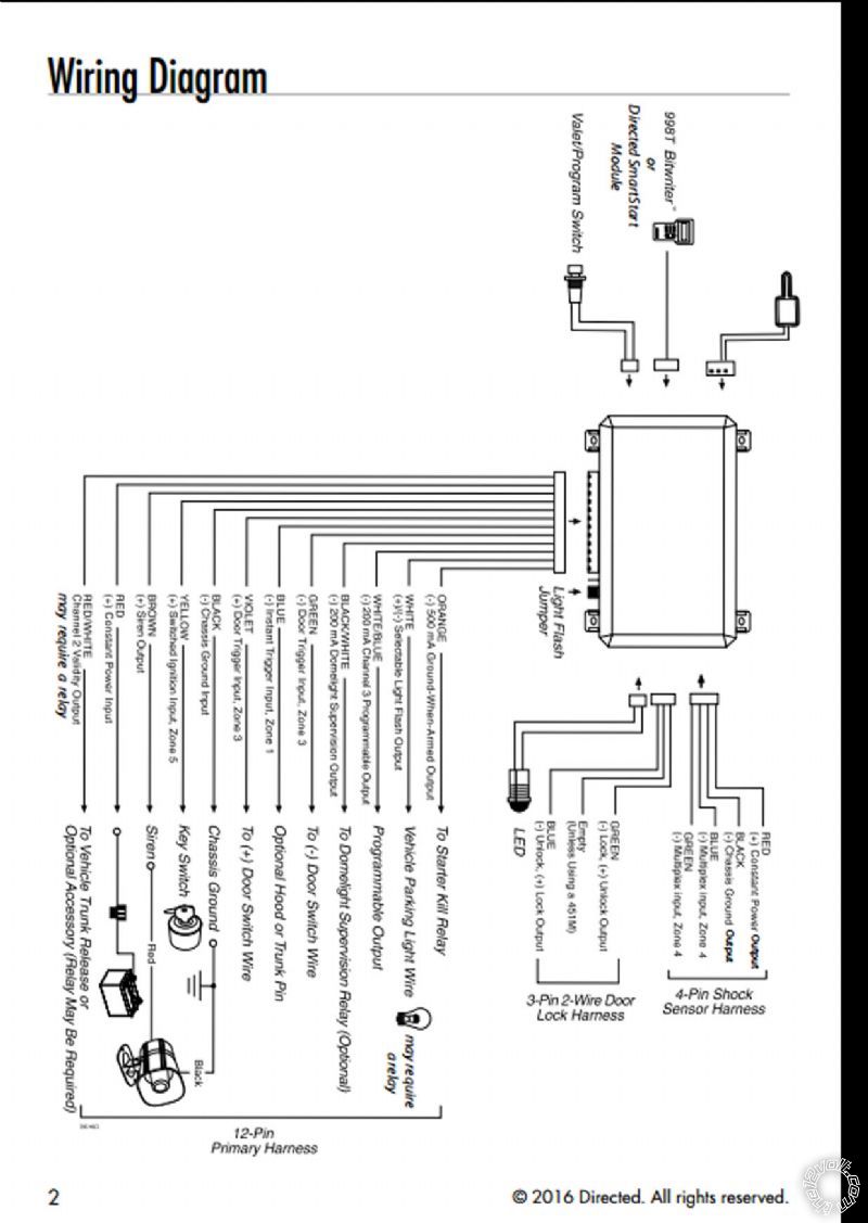

Hello all, i have issues getting the alarm to unlock and lock when disarming and arming the alarm.
The alarm is Viper 3305v :
2000 Honda Civic, Viper 3305v Alarm -- posted image.
honda civic whires:
https://www.the12volt.com/installbay/forum_posts.asp?tid=63385&tpn=1&en=ts
I hook the green wire from the alarm to POWER LOCK|GREEN / WHITE
    and the blue wire from the alarm to POWER UNLOCK|GREEN/ orange
What i'm wrong i'm novice.
geepherder
Platinum - Posts: 3,668
Joined: October 27, 2003
Posted: December 02, 2016 at 11:41 PM / IP Logged Link to Post Post Reply Quote geepherder
Looking at the diagram, your green and blue in the Viper harness need to be swapped, since green is unlock (not lock) and blue is lock (not unlock).

Thank you i tried but still not working
I also have the original remote for lock my car
Any help for my alarm? Please
