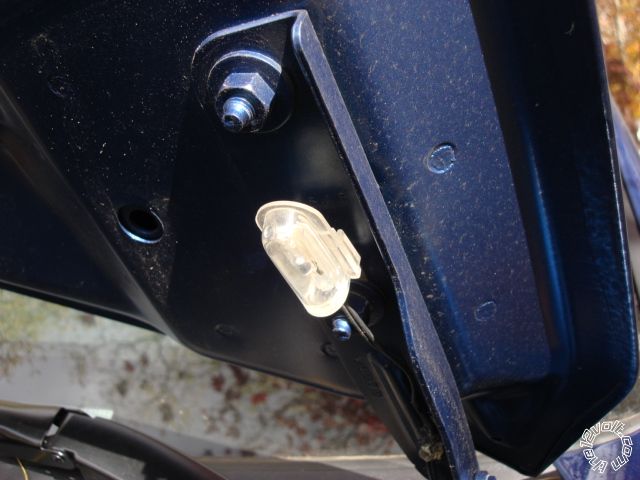

pin 4 (-) pin switch-- seems flimsy and wasn't going to use if not necessary
        And they are prone to rust. Get a mercury tilt switch and install under hood hinge bolt.
2000 ford F250, Avital 4105L remote start. -- posted image.
