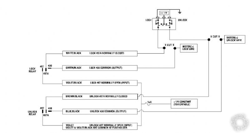

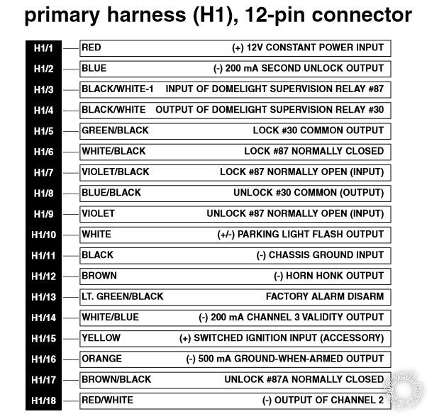

Here is Model 211HV wiring harness & diagram explaining what a remote keyless system would look like to a 5 wire power door lock system applied to such as 2004 Ford F-250:
Model 211HV Harness
Viper Model 211HV Installed on 2004 Ford F-250 -- posted image.
Wiring Diagram Shows Exactly Where To Properly Cut Wires & Interface The Connections
Note: Model 211HV as previously mentioned is equipped with 2 Onboard Relays WithIn The System Module ( this diagram below shows how this looks connected to 5 wire power door lock vehicle from a best perspective of both relays within a remote keyless module such as the Model 211HV
Getting Back To Finding Proper Lock/Unlock Wires
What I did to find my proper lock/unlock motor wires is cut in half all 4 like wires in the area found behind the passenger kick panel. Use colored tape or whatever to mark each wire end after making the cut. You want to do this so you don't make a mistake rejoining the 2 wires not needed properly once you find the correct 2 wires needed.
I then removed both driver/passenger sides of the trucks door panels in order to complete the continuity probe starting from the kick panel to switch side and motor side lock/unlock wires leading into the actual door. (There are Youtube videos that show how to remove door panels for a Ford F-250).
After cutting the 4 wires you'll have 8 connections now to test for continuity or not. Breaking this down you'll have 4 wires to test heading north upward into the dash or front passenger door and you will have 4 wire connections to test running south to the back seat passenger door.
Hopefully your multimeter will have the beeping feature when continuity is found between wires otherwise you'll have to actually look at your screen each time to see a continuity reading on the meter makeing testing a bit more challenging.
Here is the simplest way to find the first 2 of the 4 wire end connections you'll need. Mark the first 2 wires that have no continuity to either the driver or passenger power door lock switch harness. These 2 wires without continuity are the motor side of the connection just the same as seen in the diagrams above. The even simpler way to find your last 2 connections will be upon that you didn't forget marking the ends of your original 4 cut wires is to take the opposite connecting wire to each of your identified motor wires that had no continuity and that will be your switch side connecting wire. Wala!
Now go back and reference the diagrams above and apply that to what I just outlined for the preparations before making the proper connections between the Model 211HV module harness and the 2004 Ford F-250 for remote keyless wires. My sincere wish to help those better visualize making it much easier for a successful install of the remote keyless portion of the model 211HV. I plan add other explained connections of the Model 211HV a bit later. Until then .... Good Luck!

I like to try and explain maybe a little better about the lock/unlock wires on these surrounding years 2004 Ford F-250s. What is commonly published and found all over the web for this vehicle's wiring diagram regarding proper colored lock/unlock wires for connecting your keyless system harness are the Pink / YELLOW Stripe Wire & Pink/Light Green Stripe wires.
As far as my 2004 Ford F-250 was concerned I identified to confirm these particular wires connected through each driver/passenger kick panels and also ran into the lock/unlock switches drivers/passenger sides. I also said however that these were not the correct wires for connecting into your remote keyless remote system.
After grueling trial and error & multi-meter testing I discovered these wires Do Not run to the lock actuator motors at either door and that is specifically why they're not the correct lock/unlock wires to hook to the Model 211HV. I traced the wires and learned they connected both drivers/passenger lock/unlock switches thus making them both work essentially as master switches. So in other words my truck per say reiterated you have the ability controlling all locks with either the drivers or passenger lock/unlock switch. This further means you may mount your keyless remote module either under the drivers side or passenger side. I chose mounting my module under the glove box bottom panel above the floor board on the passenger side for my 2004 Ford F-250. The drivers side is harder mainly because the emergency brake and other brake/gas pedals are pitas and just make it more difficult for mounting another accessory to your truck.
I actually removed my door panels off drivers/passenger sides so I could not only preform continuity tests of the lock/unlock motor wires I actually could also physically see to conclude that the Pink / YELLOW & Pink/light green lock/unlock switch wires in no way lead to either actuator motor.
The exampled wiring diagrams above clearly outline you want the 2 lock/unlock wires that run from the actuator motor and switch. In my case that was the Pink/black stripe wire & Pink/light red wire I wanted.
I hope I explained in this thread for a better understanding about the 2004 Ford F-250 having a unique Type C or 5 wire door lock system and exactly how to interface not only a Viper Model 2111HV but hopefully most of my explanations will also work just the same using other branded keyless remote lock/unlock systems.
