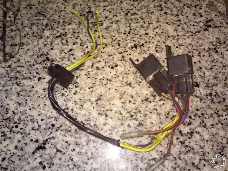

Here are pics of what I removed.

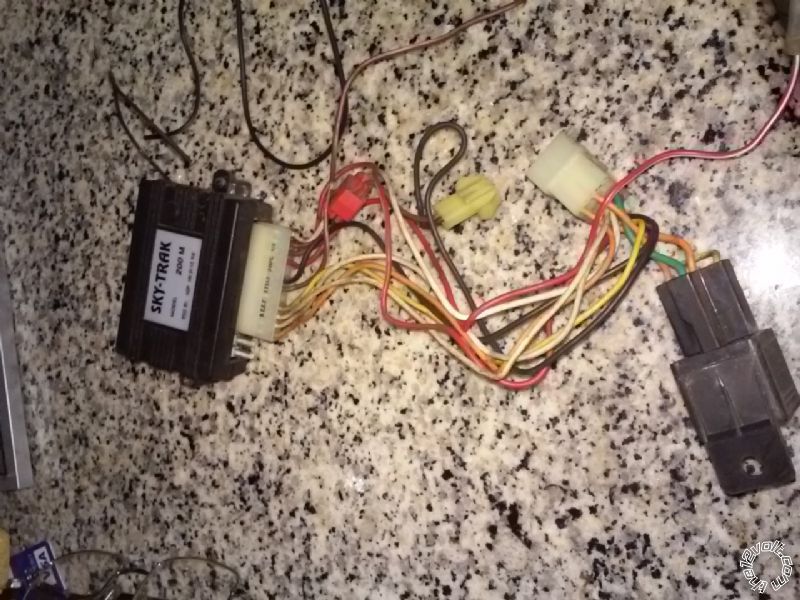

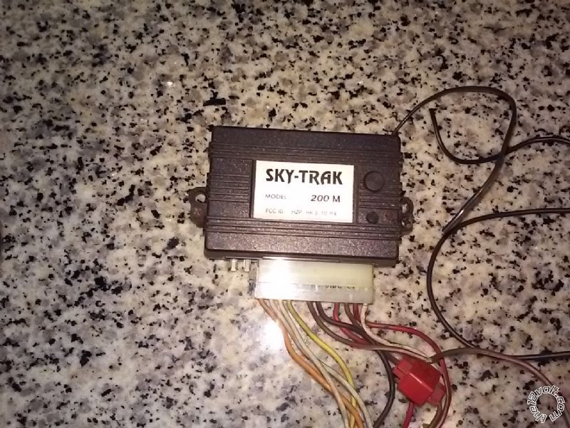

This is the main unit.
New to me 1995 Chevy Astro van Alarm removal -- posted image.
With the harness attached.

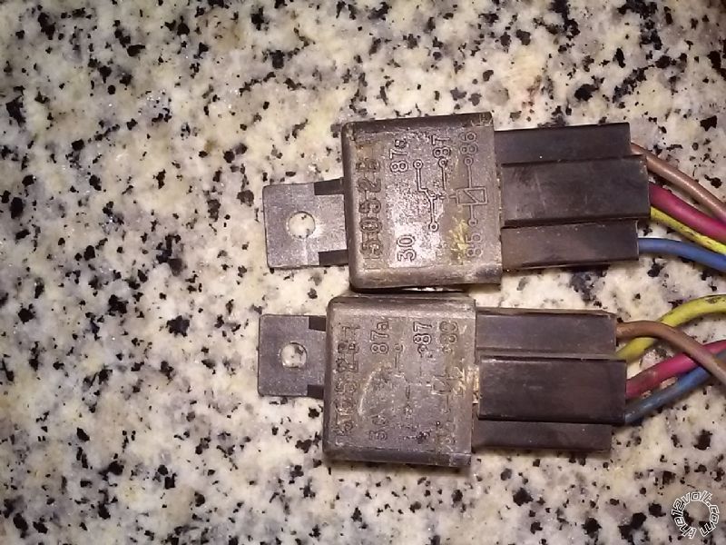

and the pair of relays tapped into the van wiring.

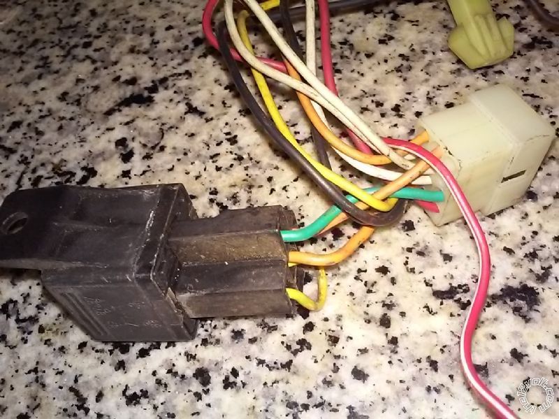

This relay is part of the alarm harness, I believe.

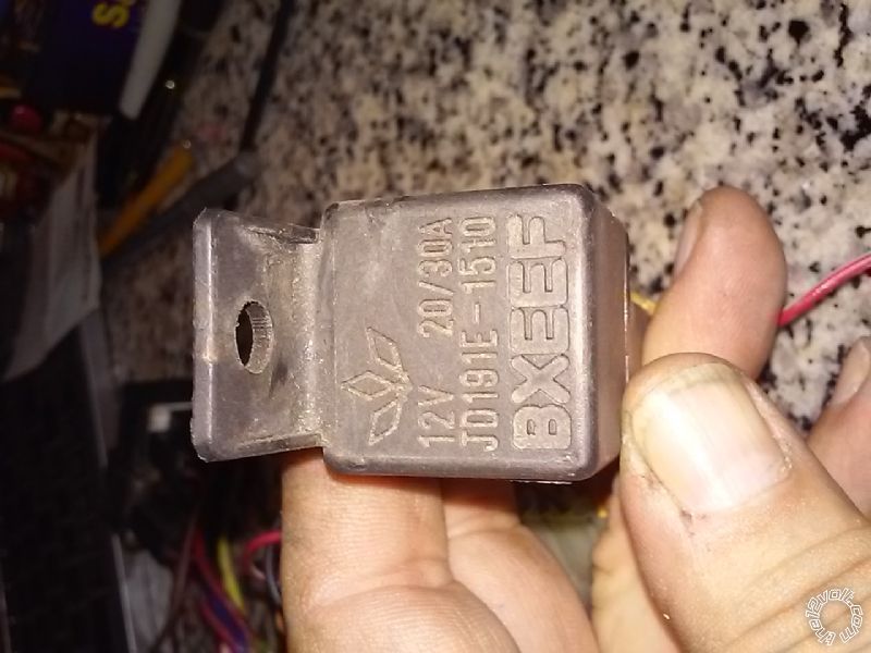

the relay info...

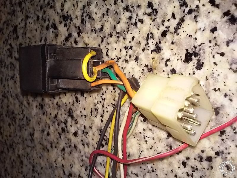

and the way it's wired.

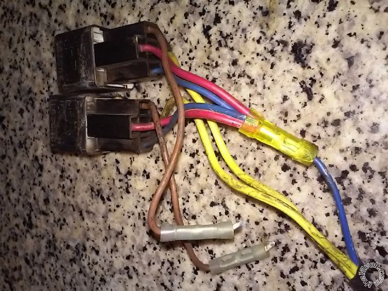

This is the other 2 relays that were tapped into existing wires..
and how they were wired.
All this was tucked into the cavity in the drivers side footwell, and covered by the kick panel.

I'm sure I've left an open circuit to somewhere but I don't know the schematics of the alarm unit or the van wiring, how the system is cutting off the vehicle start, to the fuel pump or to the ignition circuit. I just don't know enough about how this unit was wired into the van. Has anyone ever dealt with this unit before or is it standard? I looked online for this units info, manufacturer, wiring, and ran into a dead end! My searches often lead to a "High reach forklift" and a GPS unit of a similar name. I hope someone can help me get this vehicle back on the road!New to me 1995 Chevy Astro van Alarm removal -- posted image.

On the harness of the alarm, at the end with the relay and 12 pin connector. There are two thicker wires, green and orange, (terminals 30 and 87a at the relay). They are connected in as an interrupt, they need to be jumpered. Unplug the connector at the alarm module itself, and try reconnecting the 12 pin connector with the relay still present. See if the vehicle operates now.

Posted: December 11, 2016 at 6:27 PM / IP Logged Link to Post Post Reply Quote tbirdman
Ahh! It did start back up! Excellent! Thank you so much Ween! So as far as what needs to be connected, I can trim away all the rest of the wiring to the module and leave the jumpered relay connected, tuck it away and call it a day?
