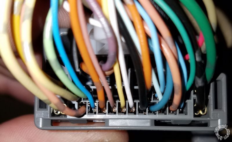

Hey guys first time posting to the site so appreciate all the help! I have a 2011 Honda Accord SE

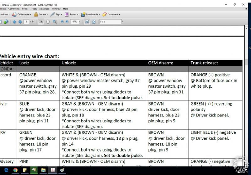

-I am installing a remote start from Crimestopper I have all wires connected and working except the door lock function. I have solder in my diodes but am having an issue with the wiring. The instructions that were made for the 2011 Honda Accord dont quite match what is in my car. See Below:
The grey 37 pin plug is there but the wire colors dont match up... Any suggestions? Thank you in advance!

Posted: January 04, 2017 at 9:55 PM / IP Logged Link to Post Post Reply Quote scottgardner795
Take your multimeter and test, the oem alarm disarm will test ground while turning the key in the driver's door cylinder.
